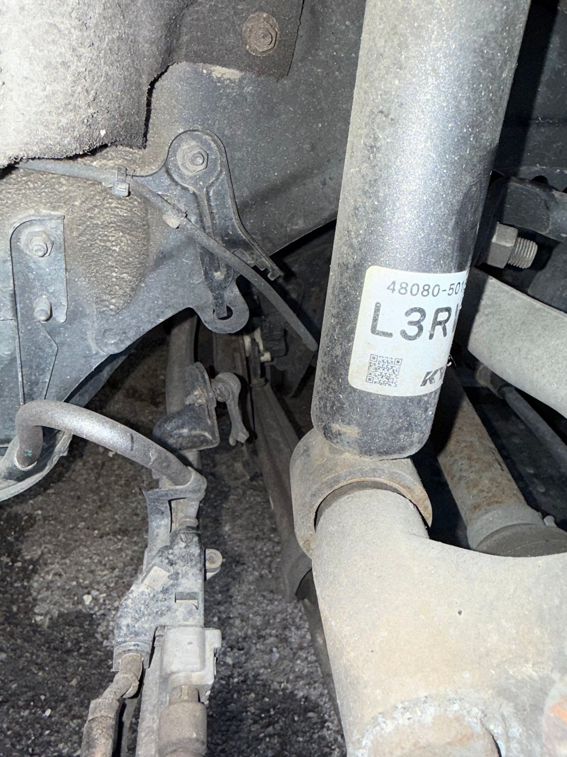

Originally Posted by pplcallmeronny
Hey guys, i’m new to owning a 2008 lexus ls460L, LWB with air suspension, so to keep it short, car drives fine and completely normal and it’s entirely stock, one day i wake up and go to the grocery store and apparently all of the air has been let out of the just the rear air struts, there was an code thrown for continuous power to exhaust valve or something like that, does anyone have this problem or know how to fix it?
managed to get some time off work and take the wheels off. height sensor is broken, i’m gonna replace it and keep you guys updated
