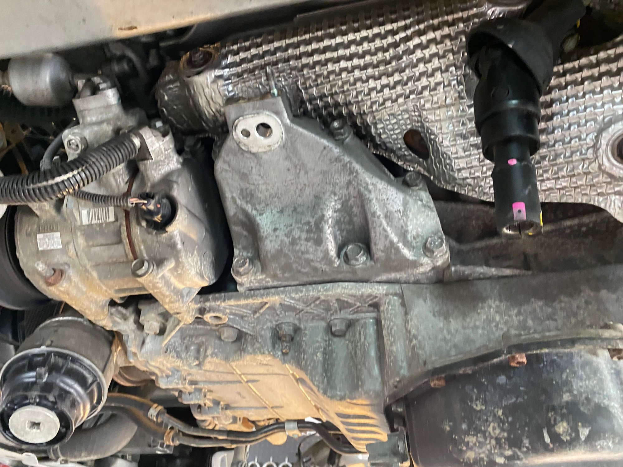

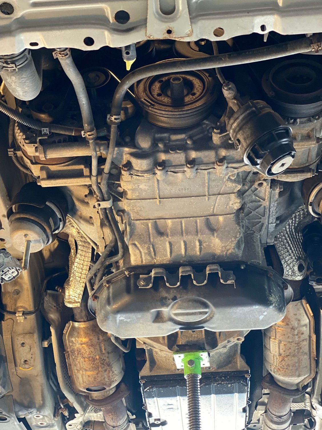

No I haven't seen it happen yet, that's really shocking as these cars use a variable compressor and full lockup like that is very rare and it should have had a breakaway safety.
You do not need to remove the engine to do this job though, at most you would remove the subframe and let it hang down on the lower control arms.
That's a RWD car but you would do similar
