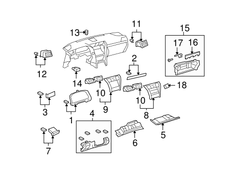

I agree with JohnnyC407 as it relates to minimal heat being generated by the VL2. I have my VL2 installed below the glove box on top of panel 5 in this diagram and I have had no heat issues. This location keeps the glove box space free.
