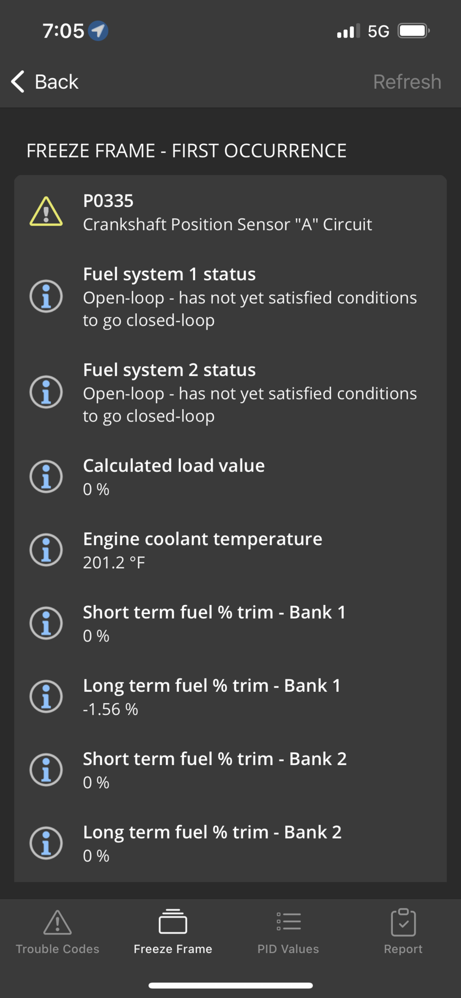

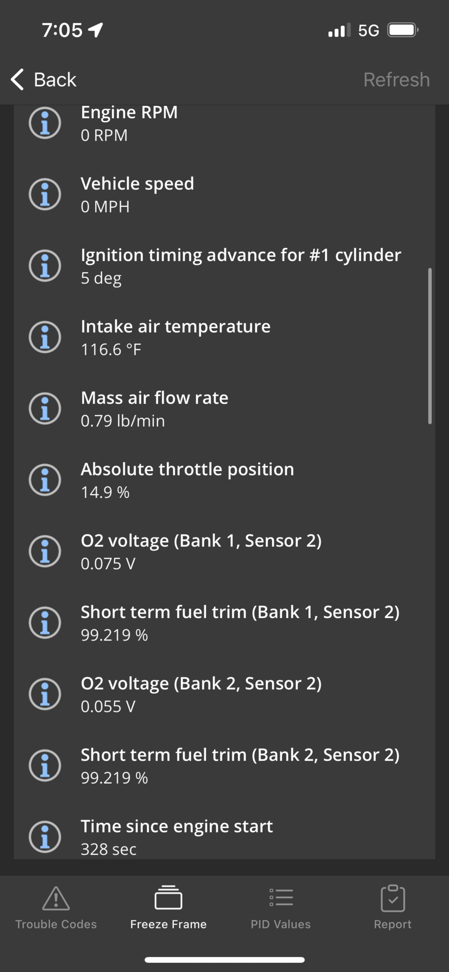

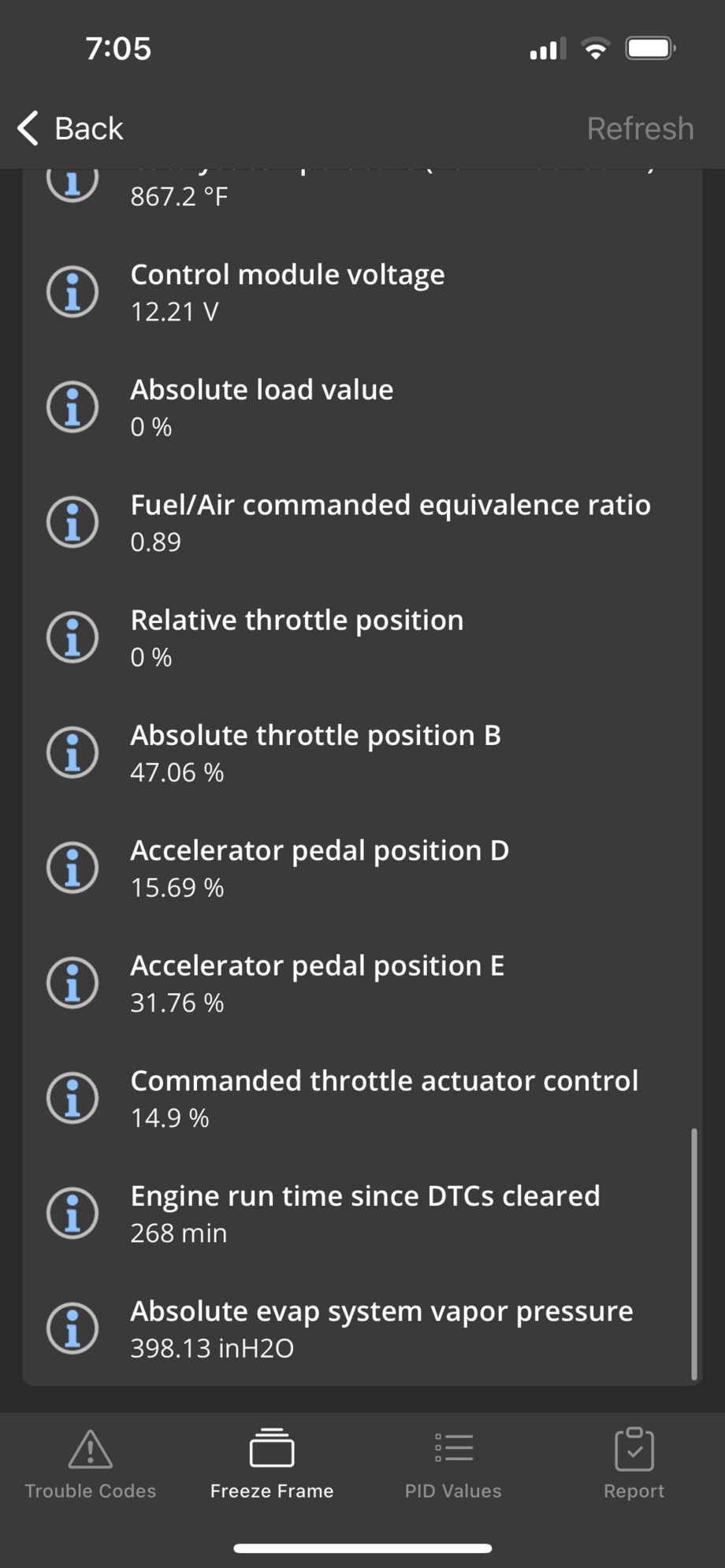

Attached is the screenshot of the freeze frame data for the most recent code.

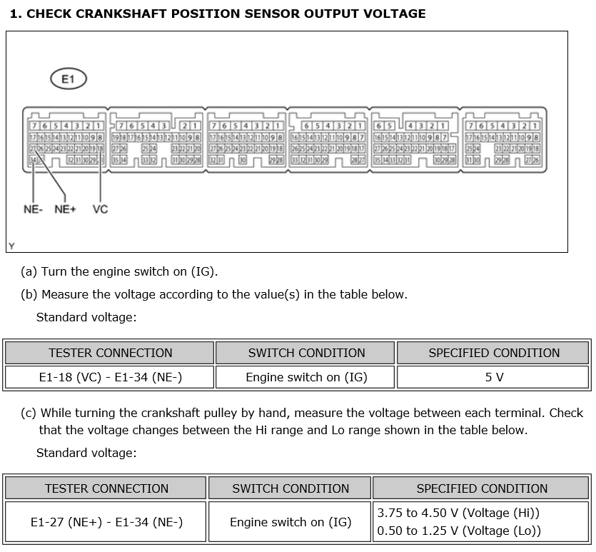

Did you actually check the harness for continuity from the ECU to the sensor?

Your battery according to the read out is at 50% charge, I would look into that.
Yeah, used a multimeter to check continuity, no breaks or intermittent issues from harness.
Are you referring the control module voltage of 12.2V?
when the car is running, the voltage according to my bluetooth obd module is 13,8-14,1V, with no big fluctuations. That should indicate the alternator is good?

You need to review the freeze frame associated with the error. It might have some clue to what is happening.
