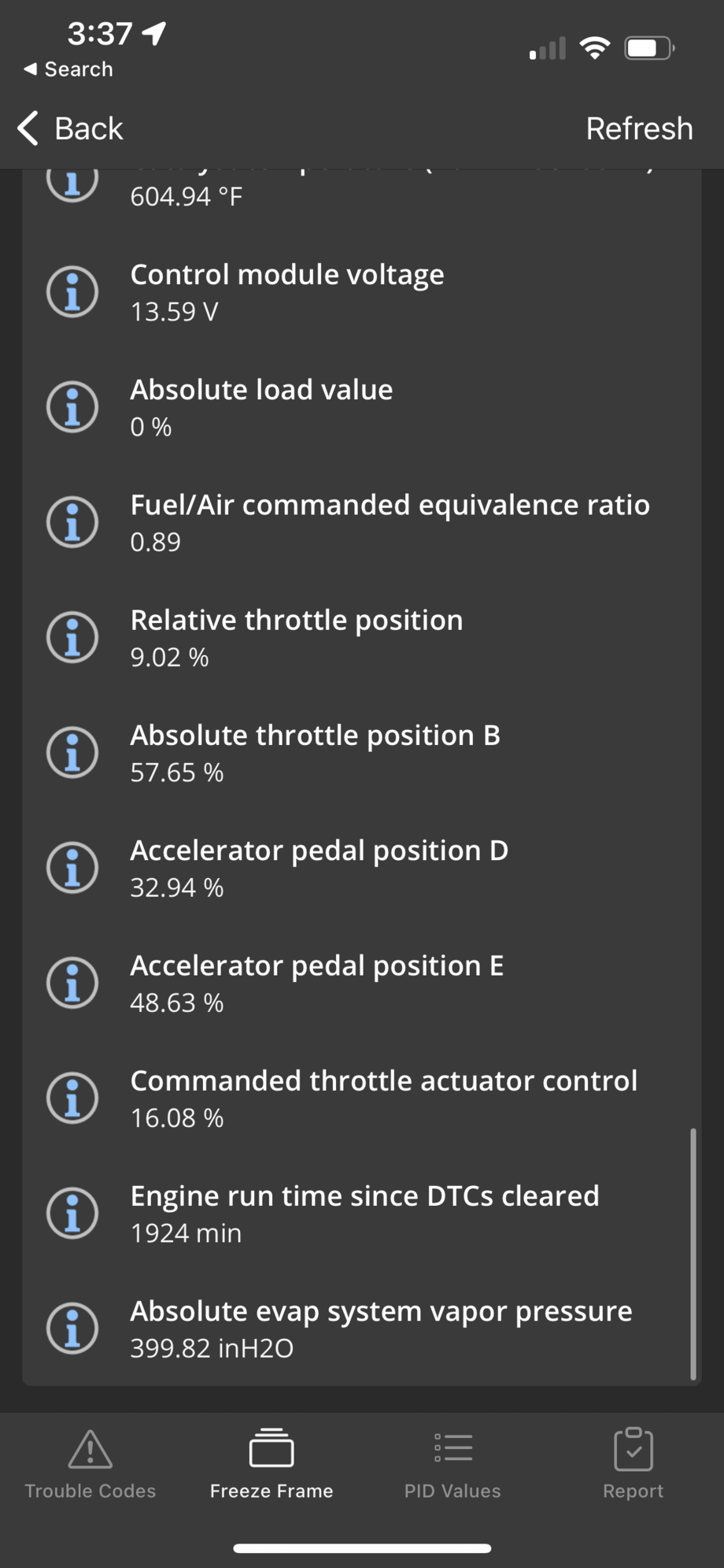

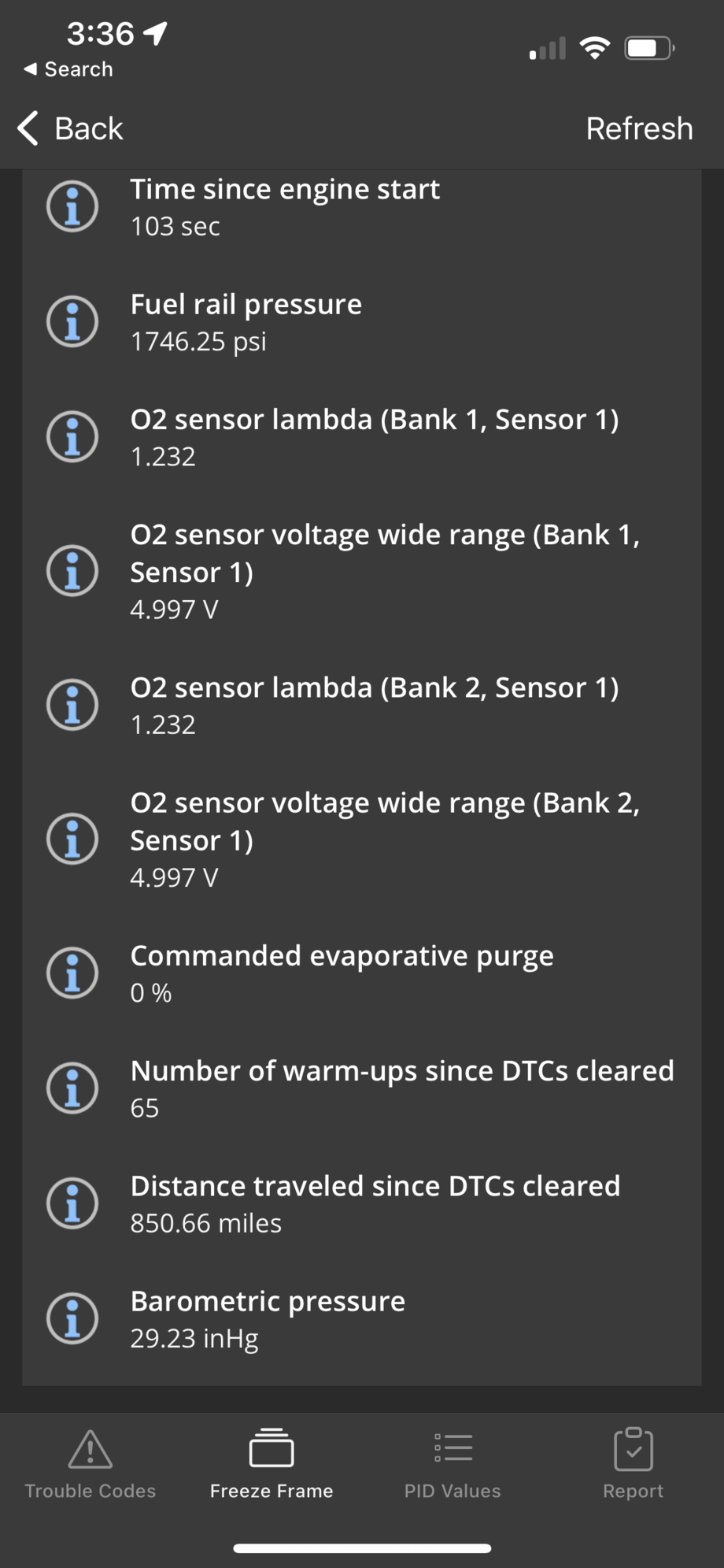

You need to compare that data to the data when your vehicle runs fine. Though, Techstream would be much better to review freeze frames.
