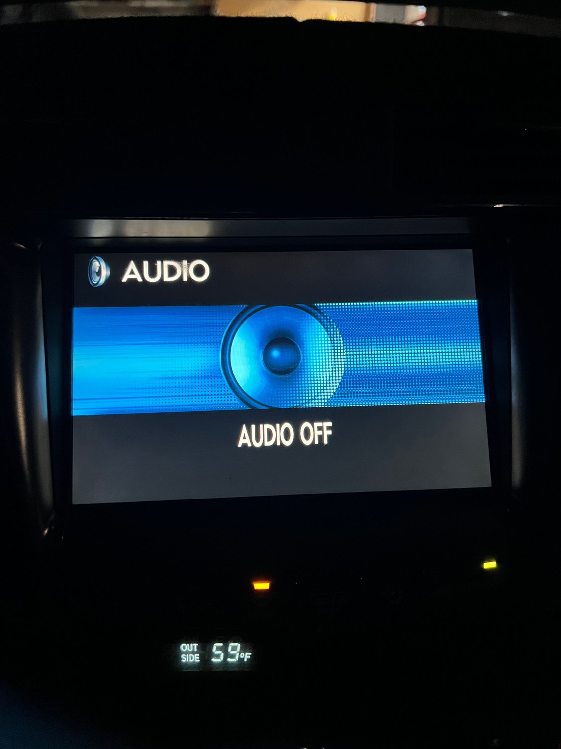

Hello, I just recently bought this 2011 Lexus LS 460. Previous owner said this occurred while he was driving. The music randomly turned off and screen shows "AUDIO OFF" ever since.
Everything on the screen works except the "AUDIO" tab. All it says is "AUDIO OFF". (view image)
Anyone experienced this?
What I already did:
Checked every single fuse, all good.
Turn off battery and turn it on, didn't work.

It is likely the amp.

The amp (in the trunk) is a known item to fail. You didn't say if you have Mark Levinson option. There are repair services that can fix the amp.
