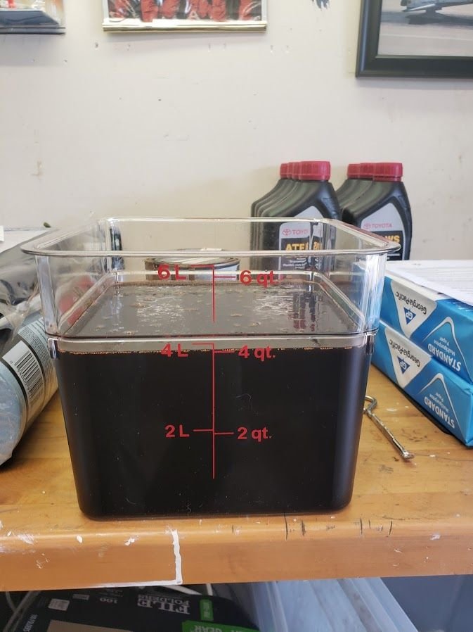

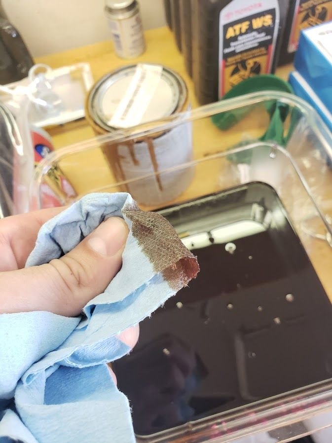

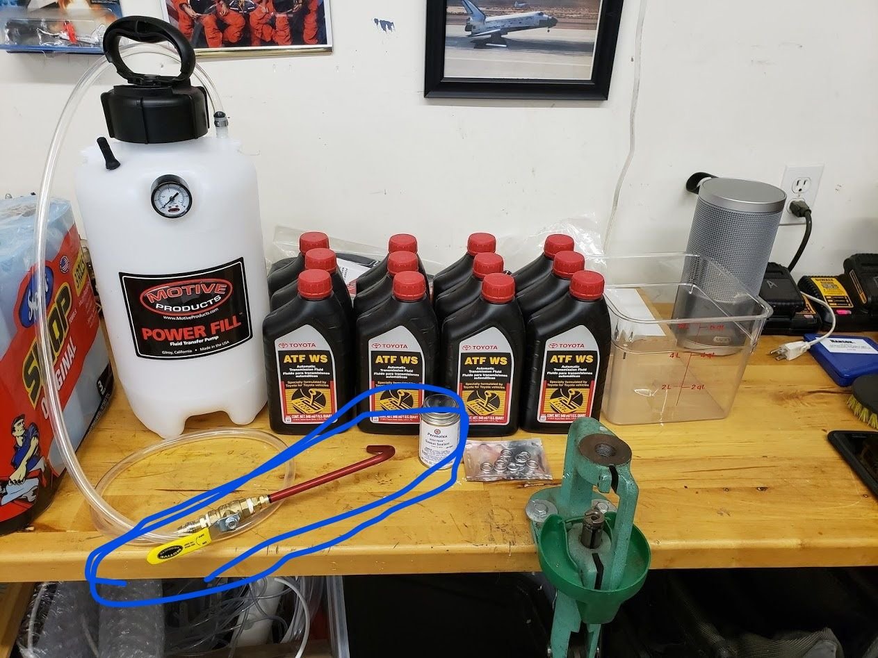

My GX460 has the Toyota WS "lifetime fluid." It was so dark when I drained it a few years ago. Could I leave it in there? Sure, absolutely. Will there be any problems with leaving it? Probably not. For me though, it's the peace of mind that comes from knowing that the fluid is fresh.
A case of fluid is cheap and getting a fluid pump makes the job go so easy. The GX was simple because there is enough room to get under it. The LS will require you to have a lift or put the whole car on jackstands so you can easily get to the transmission.
Just a few pics from the GX460 drain and fill. My LS will be up when the weather cools down a bit.
