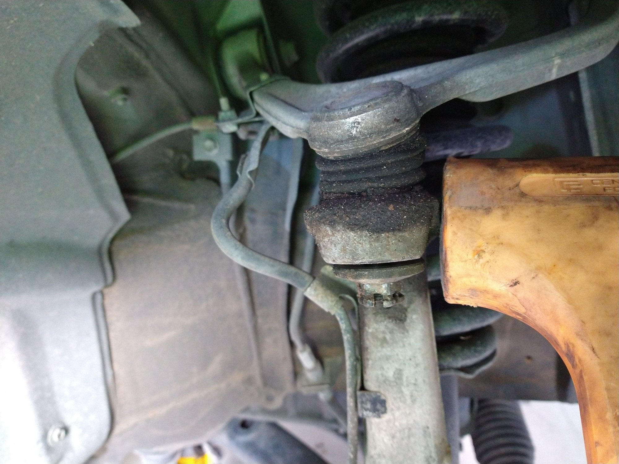

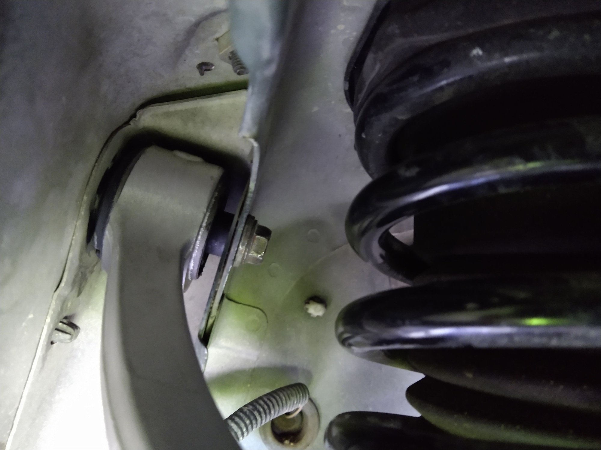

Here is what mine looked like. The inside of the bushing had completely separated and it was pivoting on that. The bushings looked fine externally. My car has 168k but I should have replaced these 50k miles ago at least.
