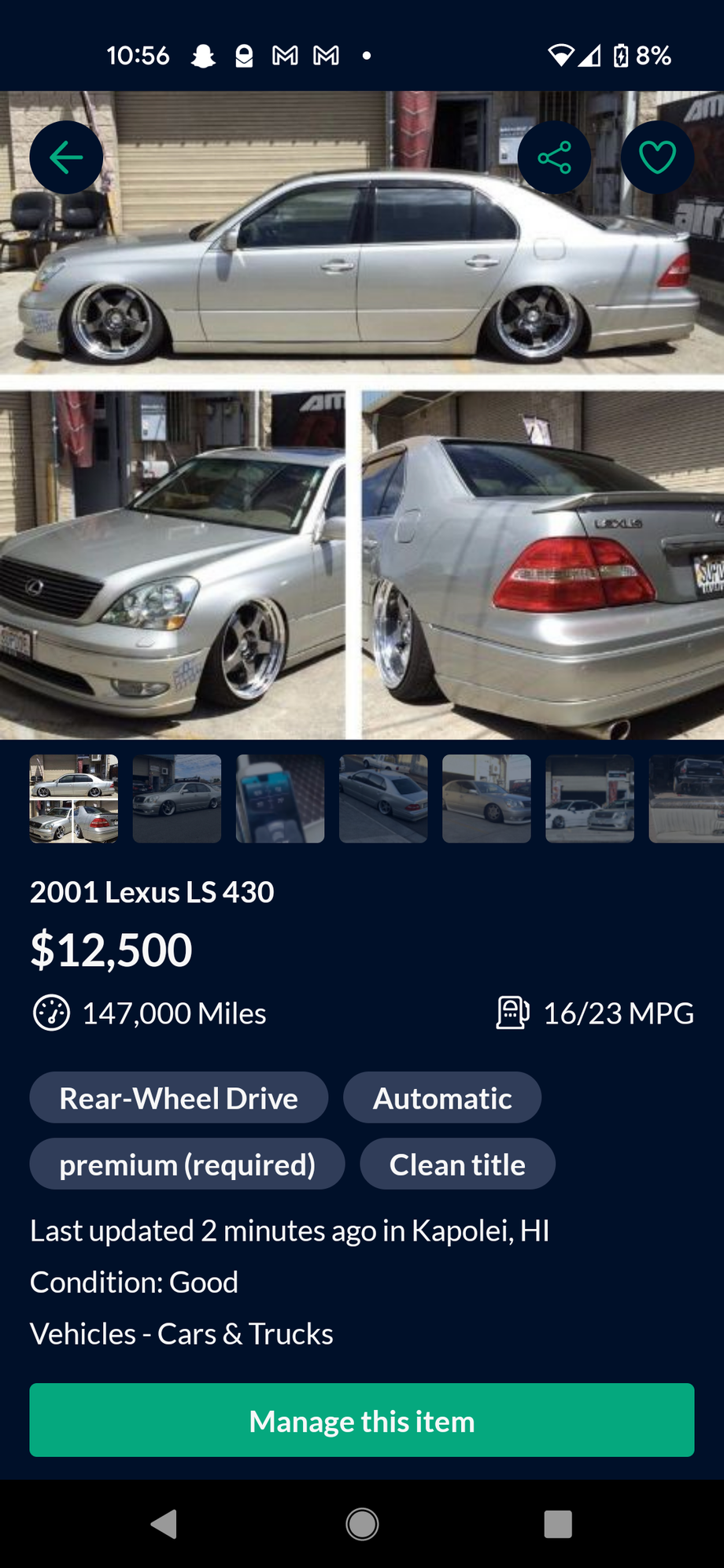

I'm hoping it turns out just to be the ECU cause I actually posted it up for sale and had a lot of interest in it. My friend in Hilo wants me to ship it up and I had another guy check it out and he and his wife really want the car too. I always wanted a 04-06, but mines pretty clean still and it's a UL. All maintenance is good timing belt was done at 90k and I ended up doing it again a little early so i everything is in top shape except the trans issue again.

Damn so you are trying to sell your LS? I bet you are sad to let it go, but i guess it's cause you want the 04-06'?
