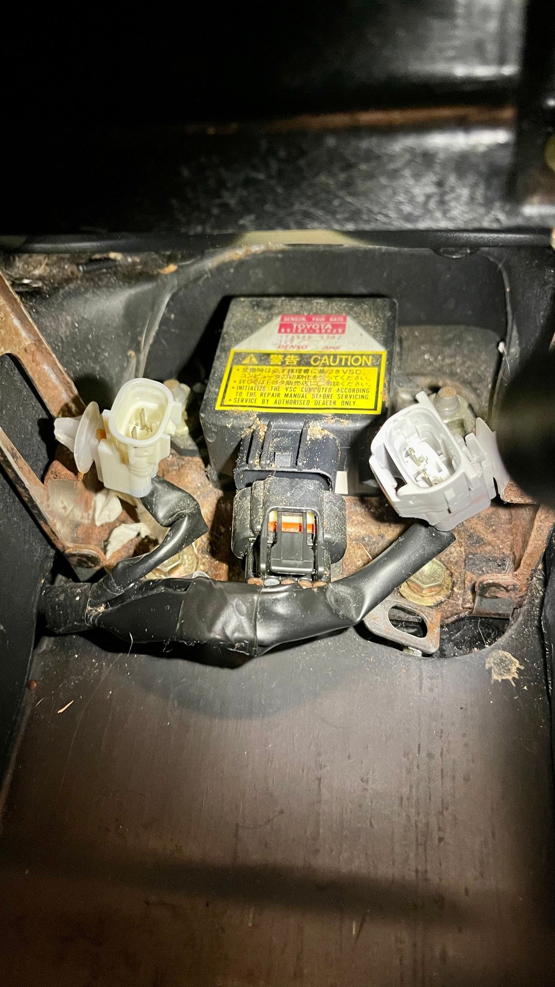

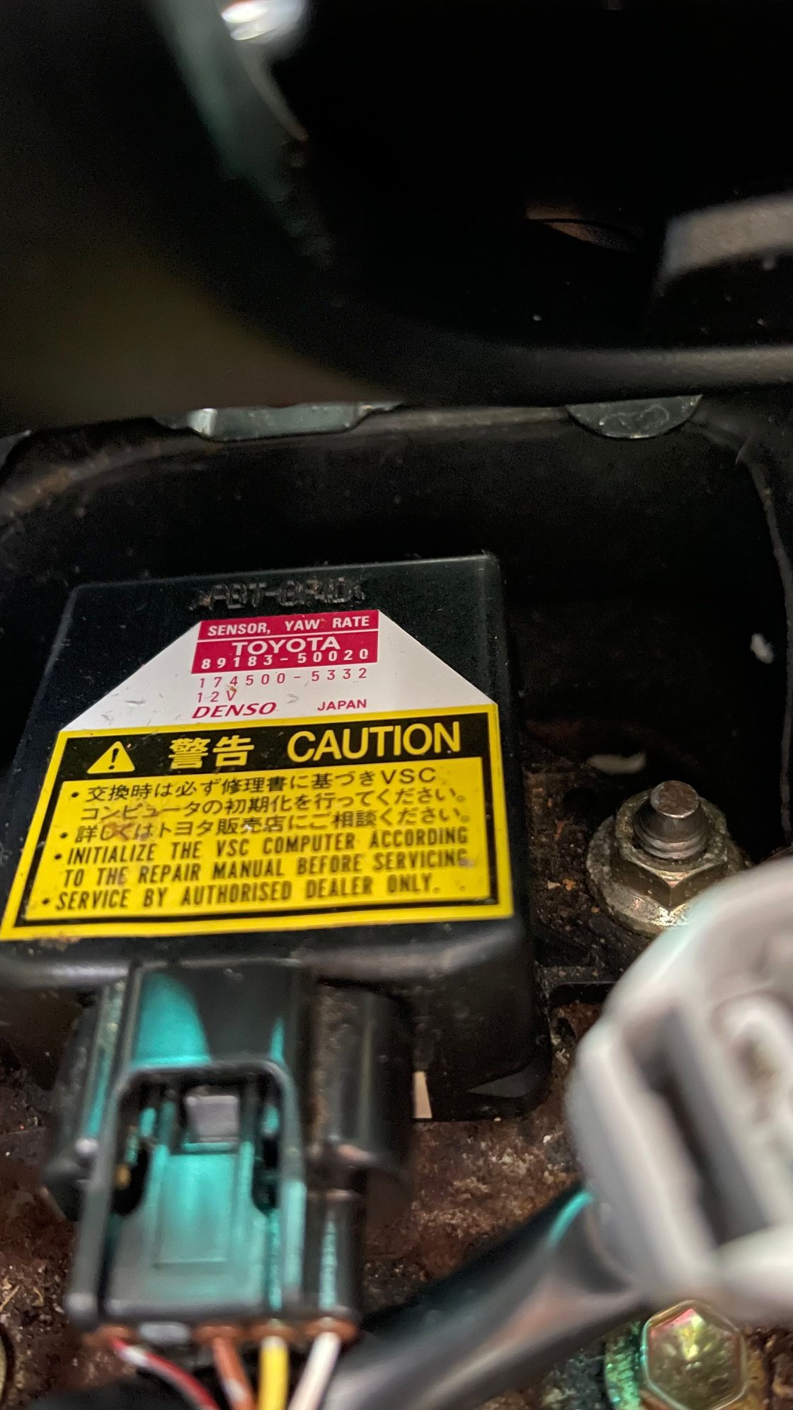

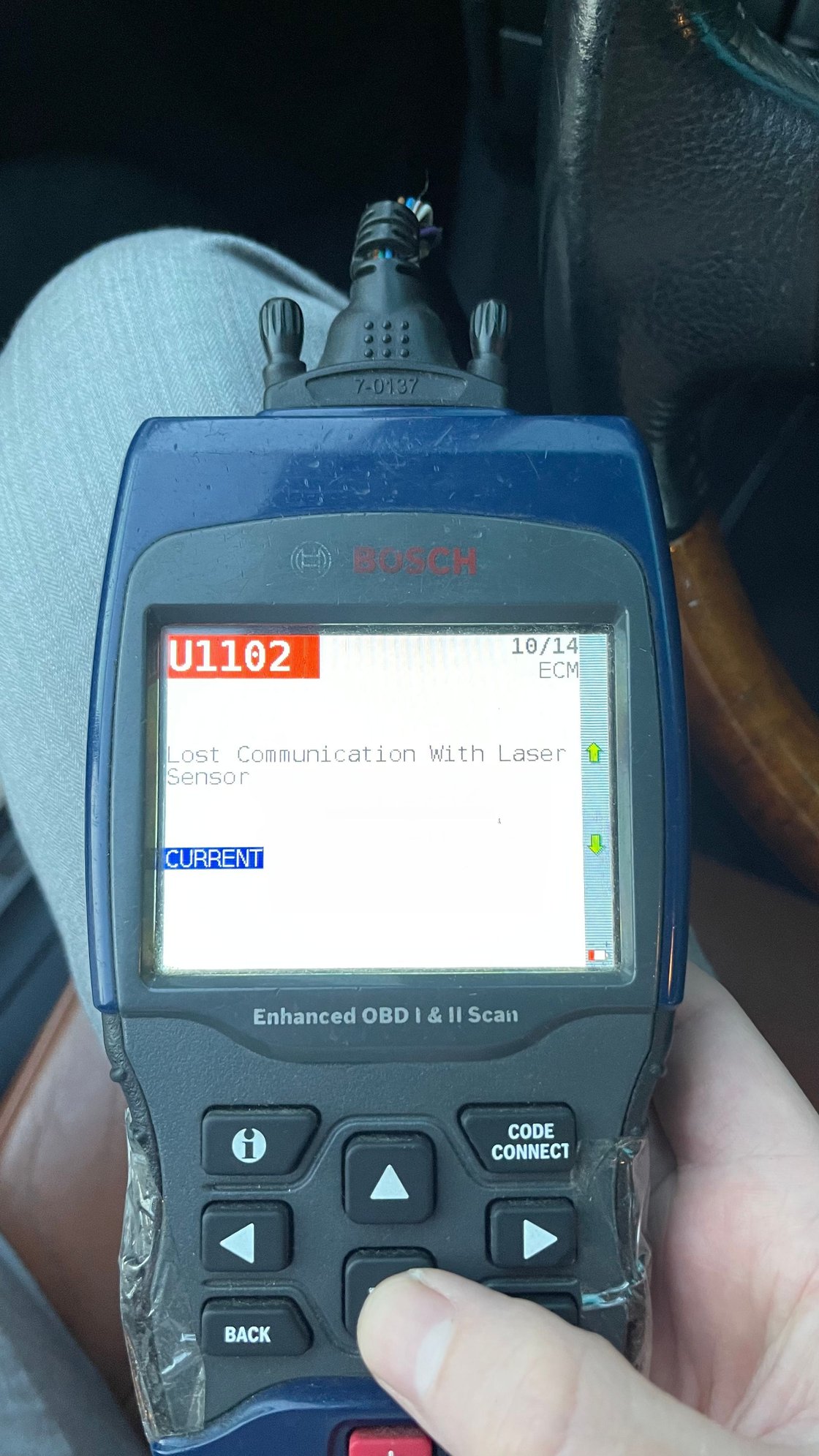

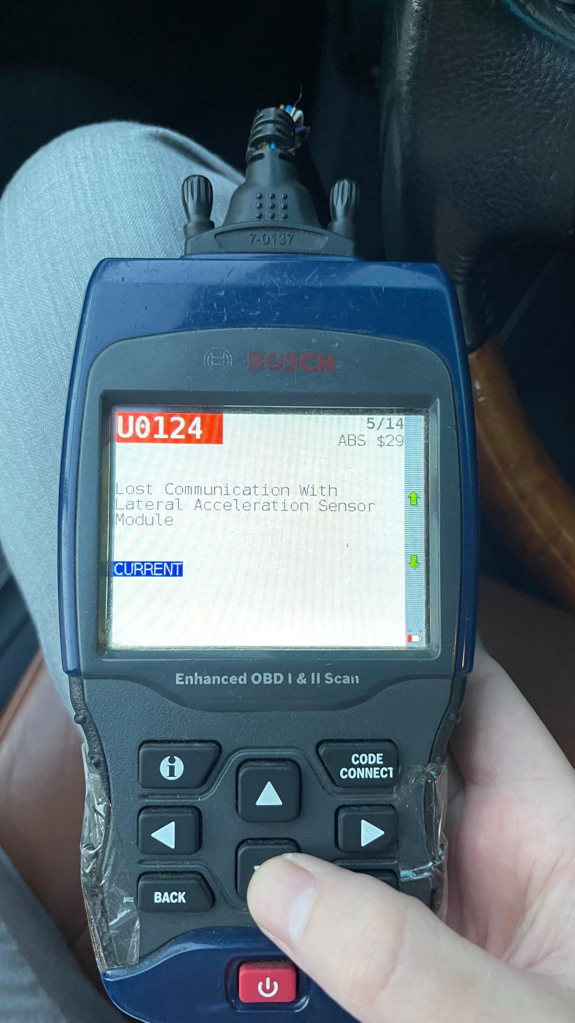

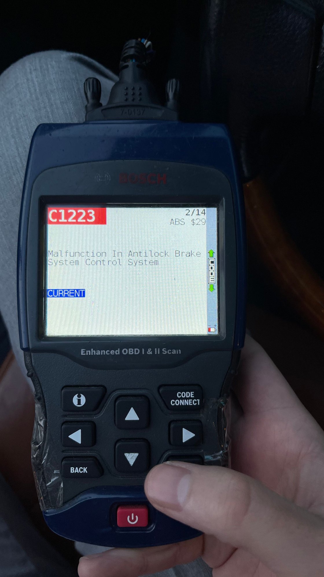

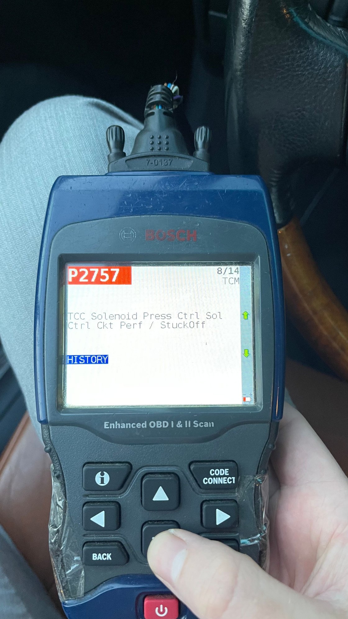

This seems to be a very common warning light caused by many different sources. It seems that if the VSC light is on by itself, it helps to narrow things down. But in my situation, all the lights were on - VSC, TRAC OFF, CHK Engine. I ran the OBD 2 and got a lot of codes back. I’ll post those up. I tried disconnecting my battery. No luck. I tried to reset using the pins to reset the yaw sensor. No luck. I finally broke down and just bought a yaw sensor on eBay. I installed it today. After installing I made sure I was on level ground and reset the yaw again. Drove for a bit and then, bam, light back on. I checked all the fuses and found a few bad. I replaced all of them. The parts store let me use their OBD reader. I used it to pull the codes. Same ones as last time. I deleted all the codes. So far, no lights have come back. I’m still very skeptical, but have a tiny bit of hope. While I was taking apart everything I cleaned. I also got to fix my center console lid that did not close. Seriously thankful for everyone on here. I could not have done all the DIY on my Lexus without the help.
So dirty down here. It looked to me like someone might have spilled their drink and it went all over the Yaw sensor.
Center console was a breeze to remove. There are post for this, they will get you through.
After removal of the center console.
Here is the alleged trouble maker. Make sure you buy a yaw sensor with the SAME EXACT NUMBER otherwise it won’t work.

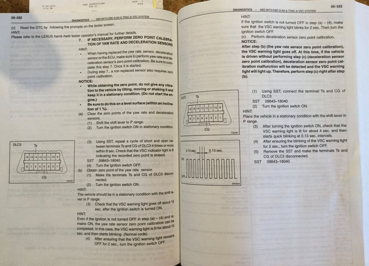

What procedure did you follow for yaw reset? I'm assuming you did zero point calibration using Techstream. Additionally, did you test the condition of the connectors and clean them? Considering that there was likely liquid in that area at one point

Finally gave up on the diagnosing. I did everything I could think of. I got some good electronic connection cleaner and cleaned every plug I could find. I did zero point calibration using the Lexus manual. The auto store was even nice enough to let me borrow their OBDII to double check no codes were coming up. I just dropped it off at the independent Lexus shop. I’m a little nervous about what they will find.
Zero point calibration procedure.

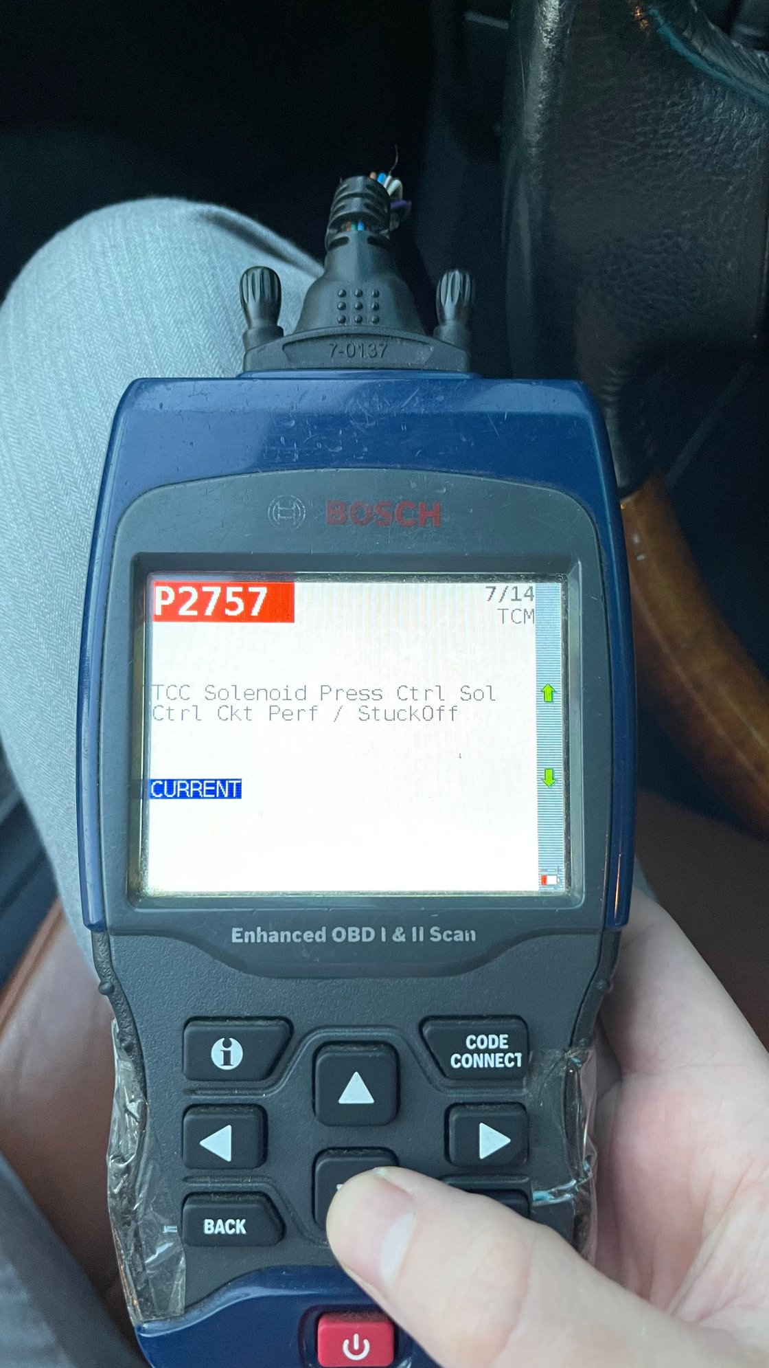

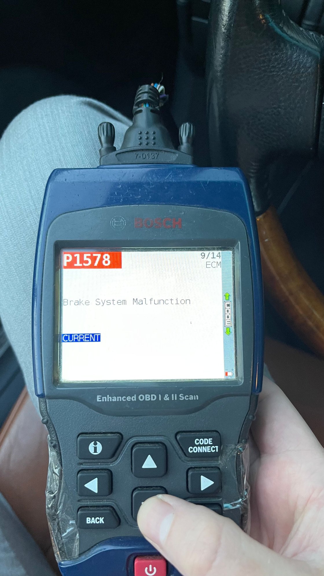

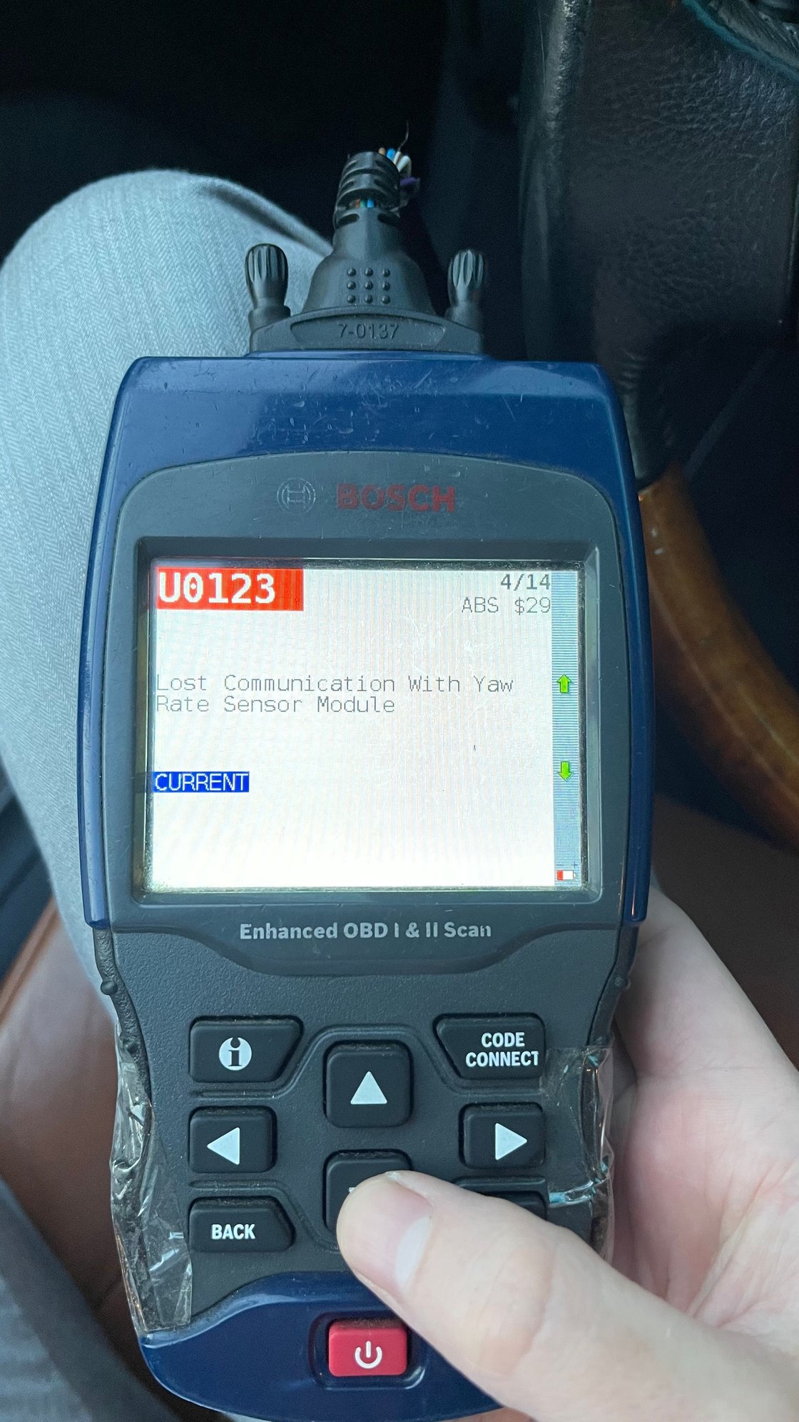

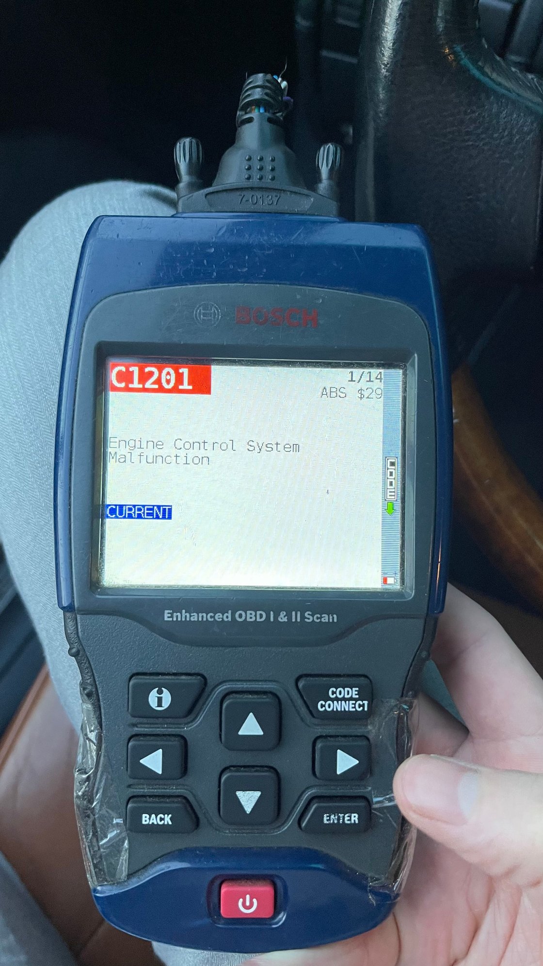

I dont see where you posted your actual error codes?

Default Photos of codes

FYI... The paper clip fix does not work on 04-06 LS430s. Have you considered going to Lexus to have them hook it up for a diagnosis?
