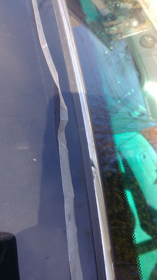

The issue was loose clear tape covering the chrome trim across the top of the windshield, flapping in the wind. The noise was higher up than I thought at first.
Here it is just for a pic, after I pulled it off and drove around buzz-free. Weird.
I don't see similar tape on other trim. Is it normal?

<LOL> That's assembly tape that should be pulled off by dealer during pre-sale prep.
There to protect the chrome during assembly and shipping.

Glad for you that you discovered the source and was able to remedy!
Your issue is a good example of how a sound from a car may appear to be emitted from one particular area of a car when actually coming from a different area of the car, and how the cause of sounds may be influenced by varying external forces, and how a sound is heard may be influenced by various factors and the way sound travels.
