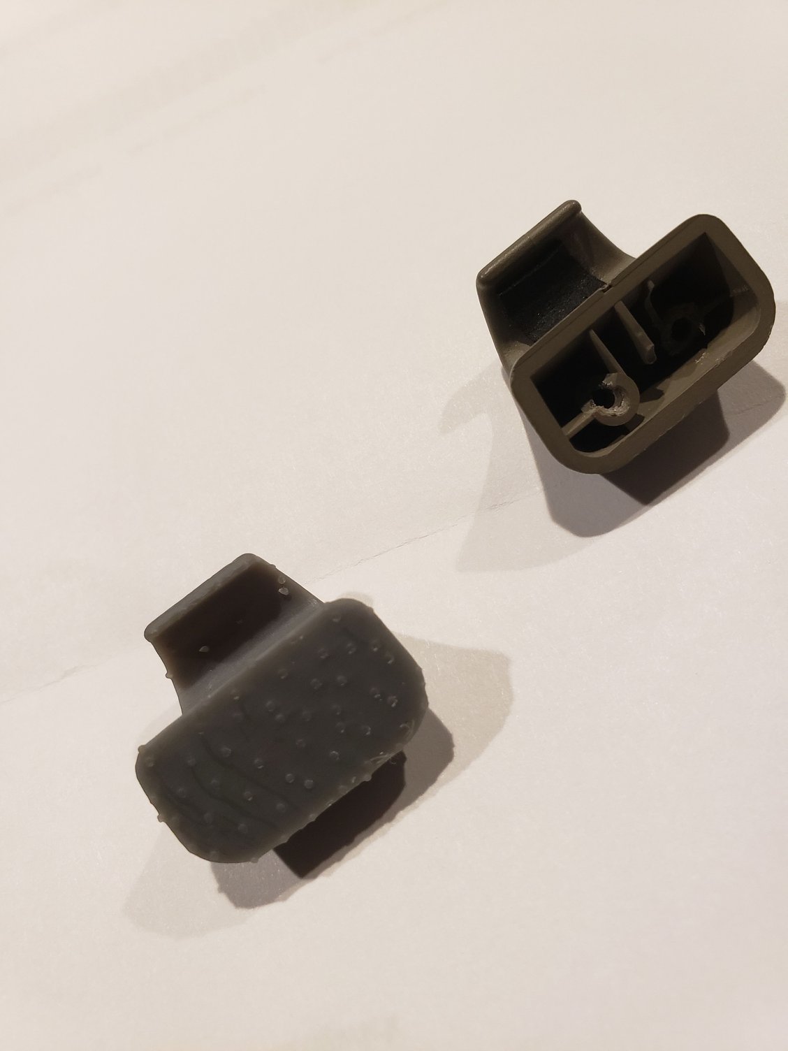

Default update:
I just recieved my completed 3d printed sunshade hooks. All i need to do is drill holes for the screws and paint to match my interior.
Here they are. The grey one is the copy. Thoughts?

That looks splendid, how much were you charged to 3D print those? I've been hunting for these and also just came to the realization that I would need to buy the entire trim piece also.

Those are looking quite Nice! I have been looking high and low for an alternative as you did from other Toyotas/Lexuses as well.
Glad to see you are working on a solution. Count me In when these go on Sale. You got my support!
