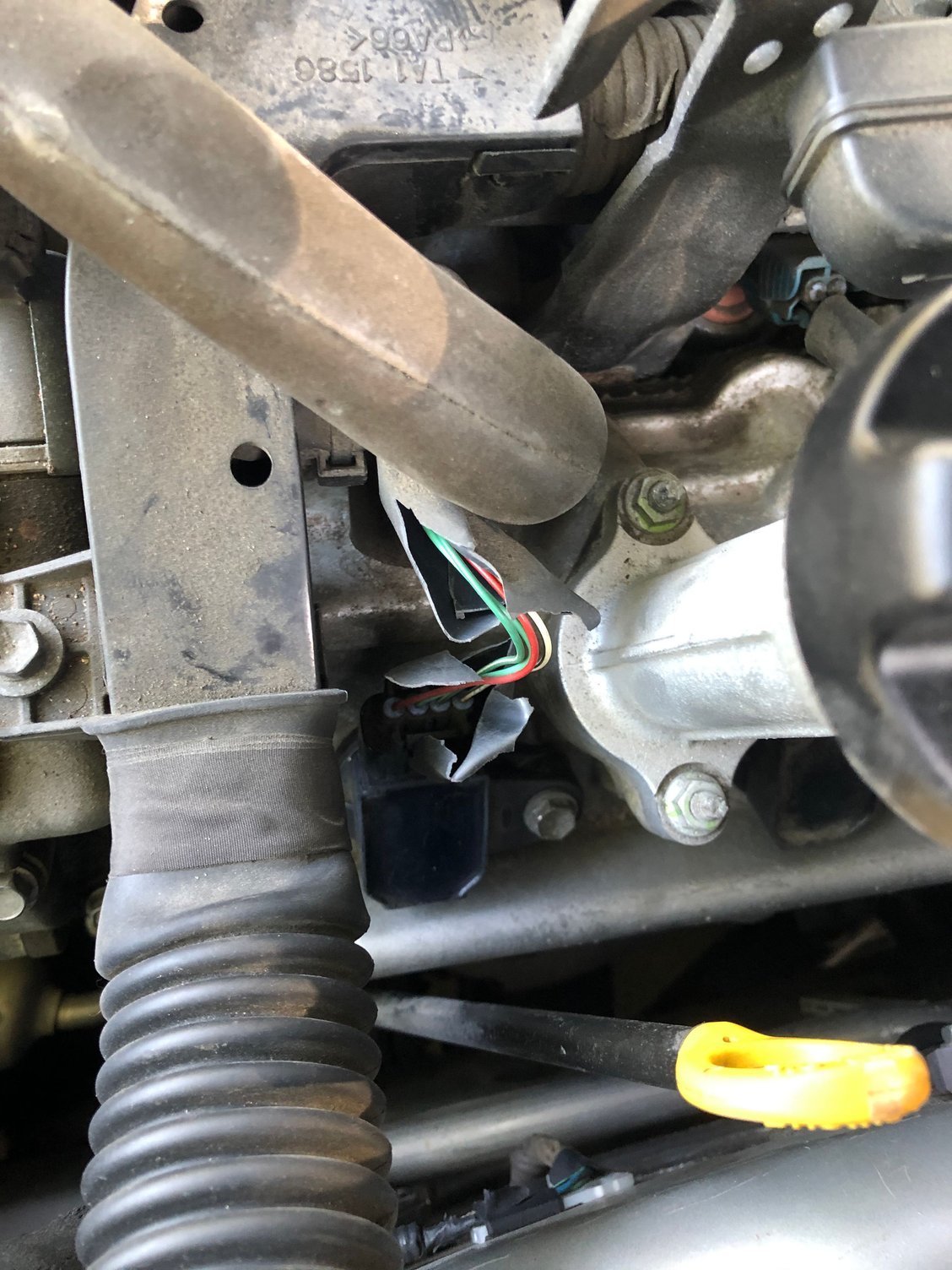

Some questions that arose while I tried to change the spark plugs on 2004 LS430 (135K mi, don't believe they've ever been changed)
1 There was a small tear on this sleeve that grew progressively larger as I finagled out the ignition coil. Is there an OEM part # for this? The service manual does not mention one. Is the car safe to operate like this?

1. I wouldn't worry about the torn sleeve, you might call a dealer and see if they are sold separately.

The sleeve isn't available at the dealer Toyota/Lexus doesn't sell it seperately, it's ok for the sleeve to be missing or torn it won't affect anything other than appearance.
