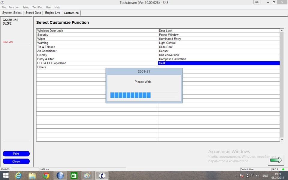

For those unfamiliar this is the "Customize" tab at the top that let's you control various user defined functions within the vehicle.
