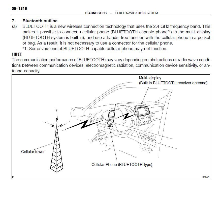

Hello friends,
anybody knows where I can find the bluetooth module?
Hope you guys can help me out.

The Bluetooth receiver and antenna is built-in to the multi-display unit.

Thanks for that! Now ill have to open up the device hoping to find the bluetoothchip.
