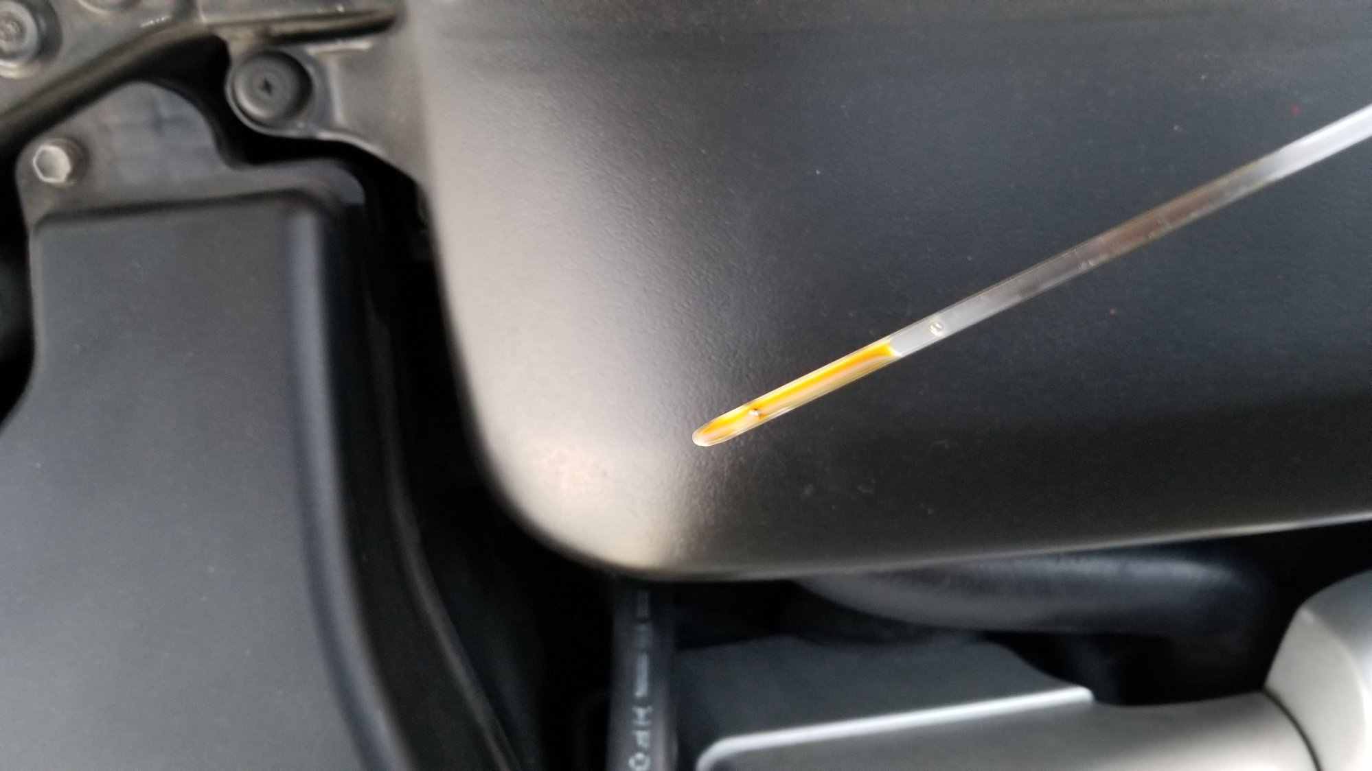

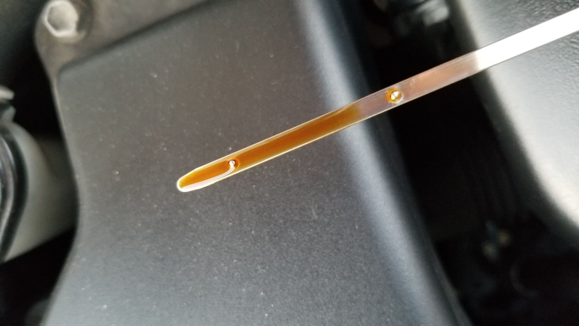

2005 ML
When I check my oil with my dipstick, one side of the dipstick has the oil level at halfway between the marks, while the other side has oil all the way up past full (like, 3 inches past full). I just did an oil change including filter and put 4.5 quarts in, so I know it's not over full.
Anyone else notice this on their car?

dipstick tube is curved at the end therefore one side drags against the wall whereas the other doesn't Very normal and happens in many cars.
Just look at the one where you see the clear level instead of smeared oil.

hehe I know we're getting a little over analytical, but I decided to look this AM, sat overnight. Never noticed this before--the handle is parallel to the fender, perpendicular to the firewall, but the actual dipstick is not. It twists and may be at a 45 degree angle to the fender.
Still, the interior is the right level, the exterior is higher. Also, the very first draw is the cleanest, still with two levels. After the first draw, the exterior and higher level is smeared.
Can you imagine, just like there is an entire generation now of people well over 40 years old who cannot drive a stick, there are people of that vintage who have never checked oil nor changed a tire or amortized a mortgage with a spreadsheet, instead shifting the focus to esports! (how are those sports lol)
the correct level and phone could not focus on the dipstick
the flip side on draw one where you can see the actual level is almost the same but higher (you can make out the actual oil level)
