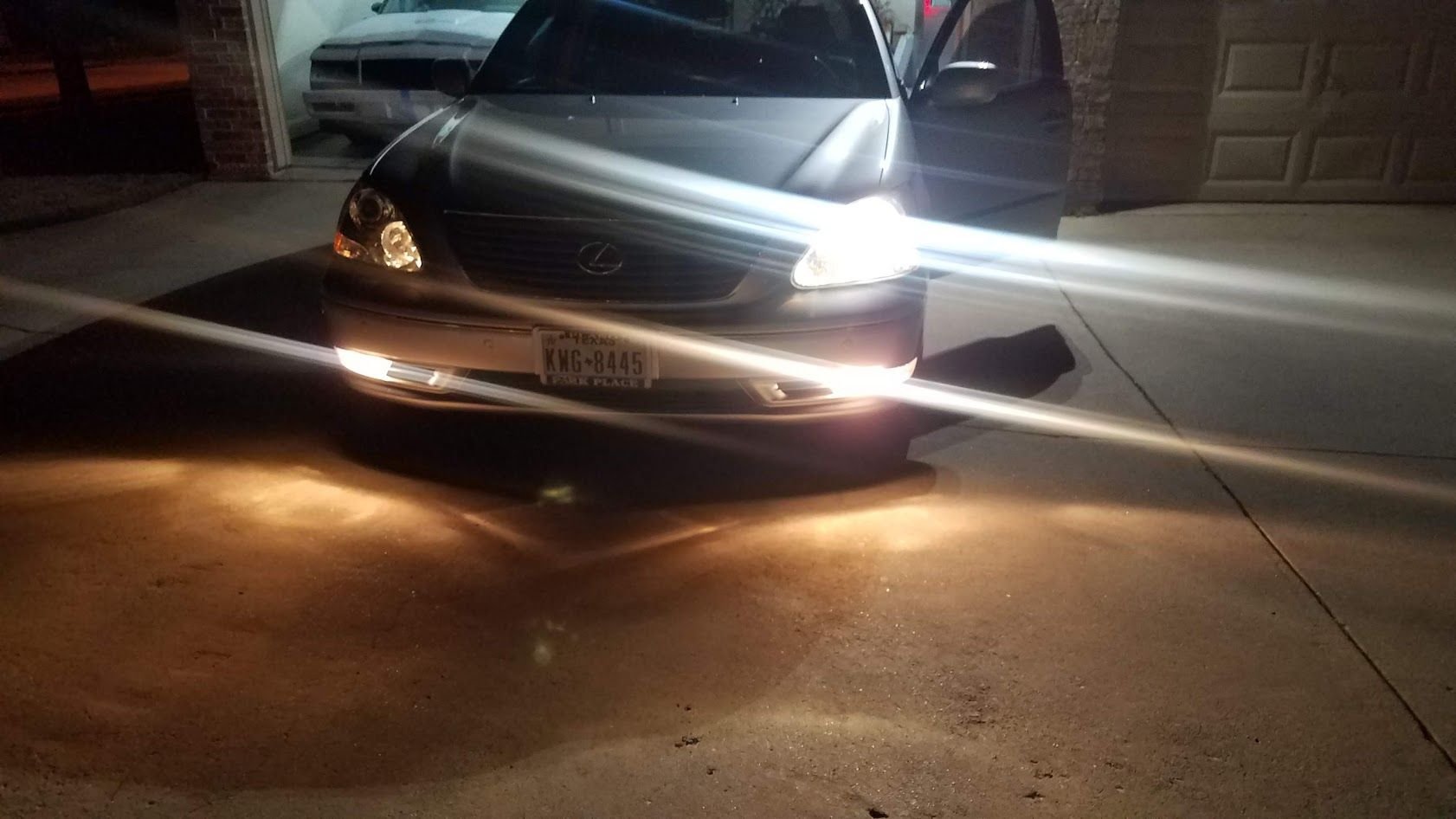

I had the same thing happen yesterday. I noticed the good ballast would make a buzzing noise when switched on and the bad one was quiet. Ordered
this this
ballast on Amazon so I can get it tomorrow before I get a ticket.
On a side note I kind of like the look of only parking and fog lights, for driving in the rain or fog. Maybe I can rewire the fogs to also have power or ground when the switch is on parking mode.
