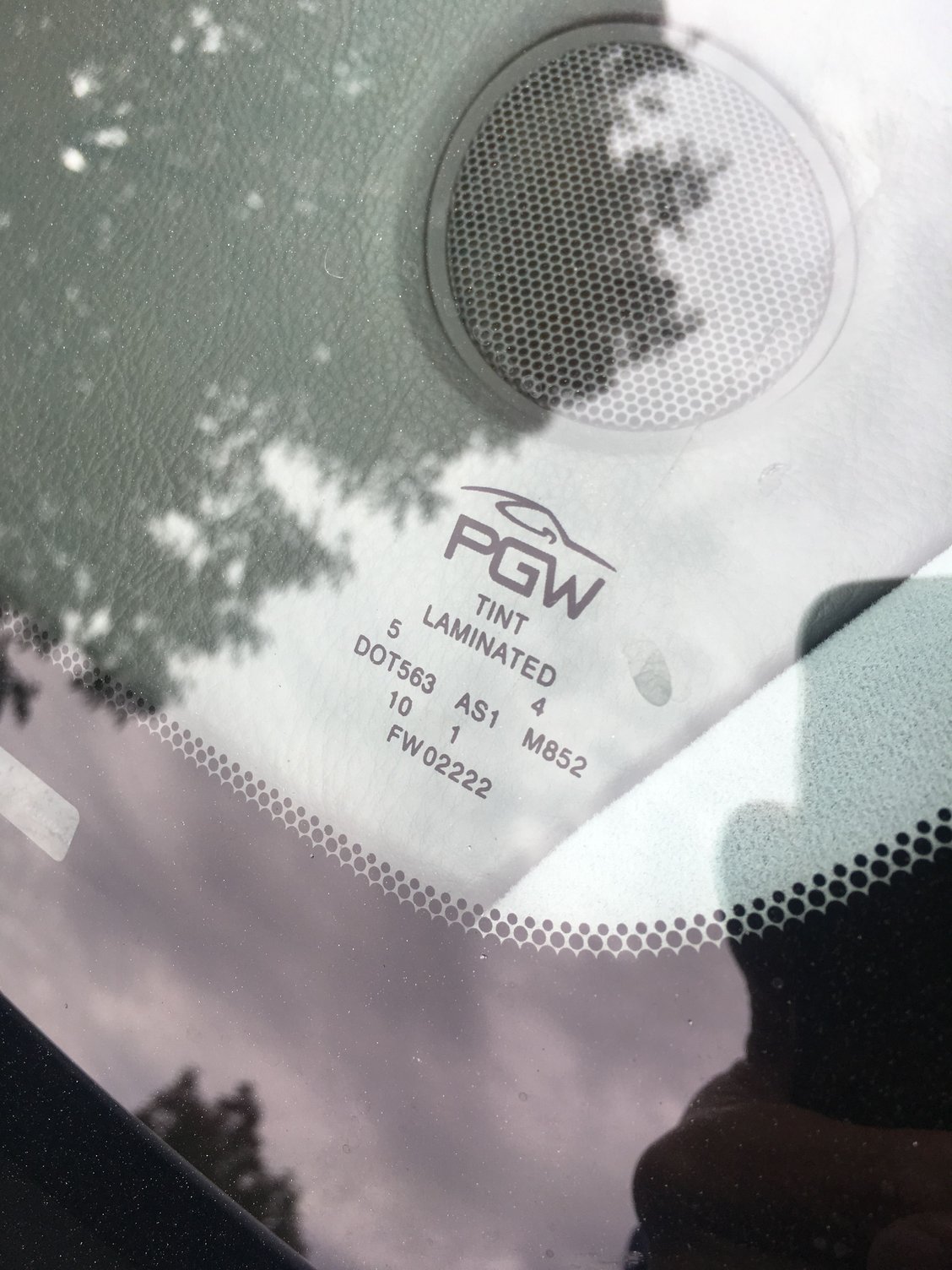

Thanks *****. Didn't realize that could be an issue. My mechanic said the replacement was of good quality although not OEM. The label/stamp on the lower driver's side says PGW Tint Laminated. Frankly, I really don't know how good it is. It looks fine. On closer observation looking thru the windshield from the outside looking in - it's hard to tell if it has the metal bracket that the rain sensor seats to. It does have the dotted pattern however on the windshield where the rain sensor is affixed. If there's no bracket, it would explain why they glued the rain sensor to windshield although it rendered it useless doing so. I looked online and it looks impossible to get a replacement bracket. Or at least I couldn't find one after doing a rather extensive search online. An OEM windshield is over $1,000 and a new rain sensor would run near $400. Will be handing this car over to one of my daughters pretty soon and not sure if auto-wipers is worth the $1,400 replacement cost plus labor. The wipers work fine otherwise and the car is in impeccable condition. Someone took exceptional care of this car and the few folks that ridden with me have all marveled at it's condition for a 13 year old car. I currently work out of town in Boise, ID during the week and keep this car in Boise as my daily commuter. I'll be done here in Boise at the end of the year and will give it to one of my daughter's who will need a new car soon and after I'm wrapped up here. I drive an LX570 at home and love my rig but I have to say that I've become smitten with this LS430. The solid luxury and silky smooth drive and shifting make me feel like I'm floating on a cloud. It's mesmerizing! I could go on and on about this car. It's so perfect in every other way that I want it to be 100% which is why I'm all twisted around about the auto-wipers. Sounds ridiculous I know. And thanks again!

Here are a couple of shots - vehicle and windshield identification.

This one LOOKS like it comes with the bracket but don't take my word for it.
https://www.ebay.com/itm/Lexus-Ls430...oAAOSwX61ZChDU
You will also need the tape to mount it
https://www.ebay.com/itm/Genuine-OEM...pe!30461!US!-1

Thanks JHarris - you're right! It looks like the metal bracket is part of the assembly that for sale. For $25 it might be worth it. I would have paid $25 for the bracket all by itself. I guess the first thing I need to do is ensure that I can remove the existing rain sensor. I'd like to try and remove it without destroying if possible. The only problem is that there really isn't any room to reach in to the area where the metal sensor meets the glass. The black plastic cover is pretty much flush with the glass as well and of course the metal pad is contained inside. Is there any way to remove the plastic housing around it without destroying it?
