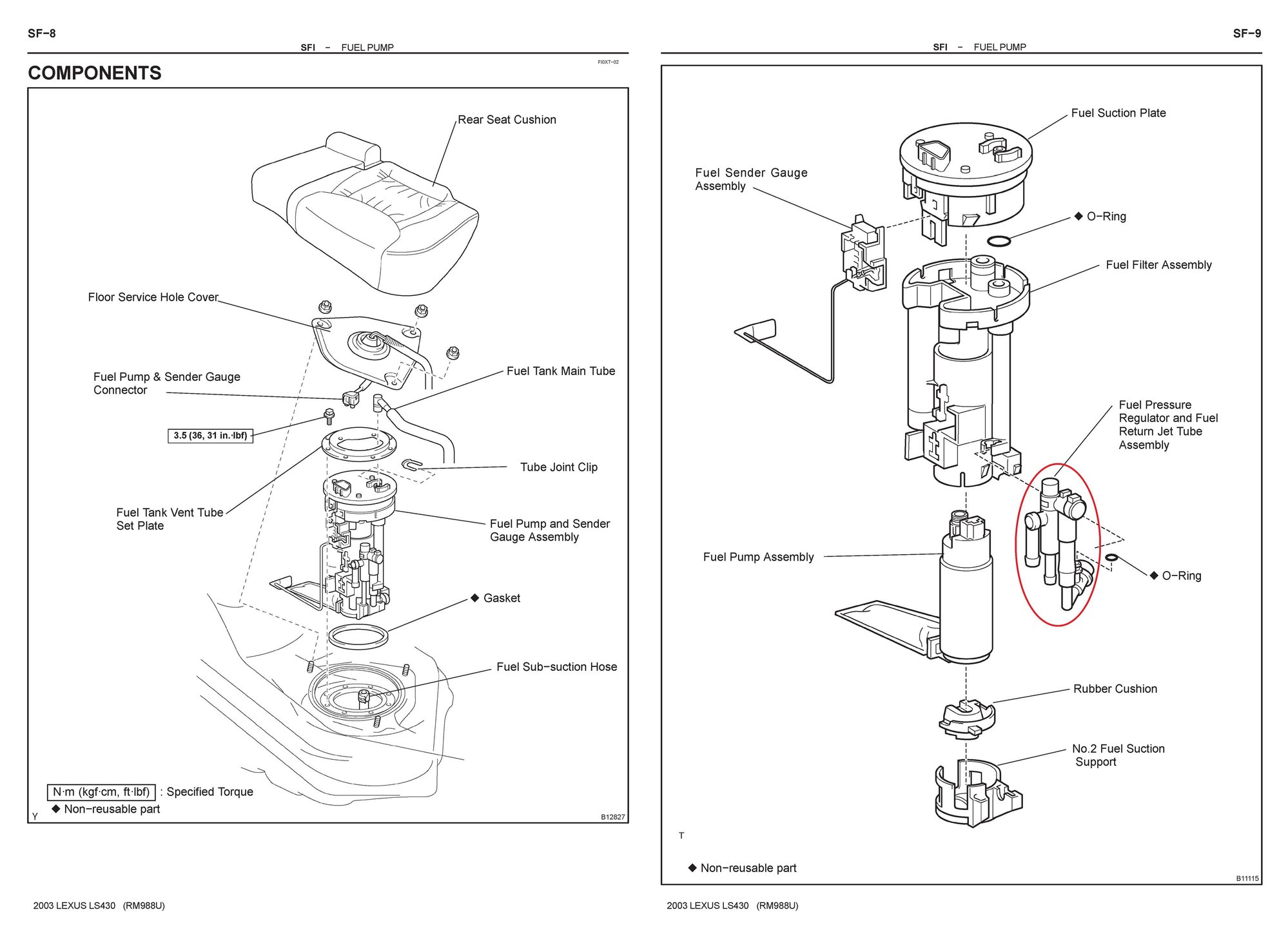

The LS430 fuel pump maintains a constant flow rate of fuel to the engine and the excess (fuel not consumed) is routed back to the tank. At the end of the return fuel line (see circled in red below), there is a pressure regulator to keep the fuel line at proper pressure. Normally once the ignition is shut off, the regulator will maintain line pressure for a little while, but for sure, the fuel line is kept filled. Next time you turn the ignition, the pump pressures up the line and everything is back to normal operation.
Here is my speculation... I suspect that the problem lies in a small leak that drains the fuel line when the ignition is off. You mentioned that the engine starts but dies soon thereafter. This tells me that there is some fuel at the fuel rail, but there is a pocket of air in the line between the pump and the rail that stalls the engine of fuel. Allowing the pump to run a few seconds, before cranking the engine (consuming fuel), helps eliminating this air pocket.
