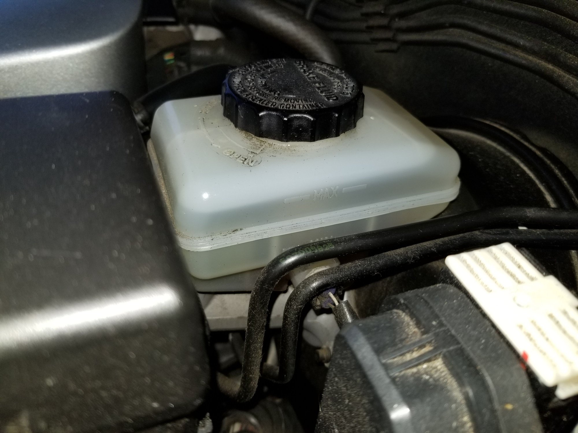

it's nice when your brake fluid looks like this

haha but it won't last.
It was like this when I went to the Lexus dealer in 2016 (they only charged $59 so I wondered if they only exchanged the reservoir). But in a matter of days it turned gold.
I just didn't have the time, so what I did was I bled through the rear left when I was fixing the tire. So that means from max to min on the old, fill up to max, repeat, then fill up, stopped. Only two max to min pushed out the rear caliper. It actually did not come out as fast as I'm used to, I wonder if I should just do the two man method with the pedal? In spring I will do all 4 calipers, but the fluid was by no means black or green, just honey...
the old

p.s. I think I'm on to something. After only 100 miles, my fluid is not clear as water, like in the first pic, it has gotten yellowish. So I bet the Lexus dealer did not bleed all 4 calipers, they did either what I did, or only the reservoir. when I say yellowish, it isn't as honey golden as the 2nd pic.
Of course, the "right" way to flush the braking system is to do all 4 calipers and bleed from furthest to closest. ABS? Not sure. With BMW, ABS is "not" part of a normal bleed, but "is" part of a bleed when a hydraulic component has been removed (not sure I follow that logic). At any rate with my BMW I did all 4 calipers and ABS (because I removed the ABS pump and BMW states it is not possible to get all the air out without the ABL bleed procedure which acutates all channels of the pump), and the fluid remained clear for a long time....(I never checked when the dealer did it under free maint)
