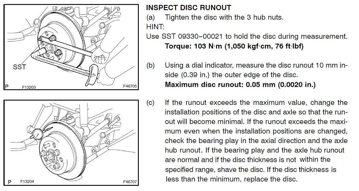

p.p.s. I never understood why so many holes in the rotor hat, seems it's so no matter how you mount it, one large hole will line up with the hole that's used to adjust the tension of the parking brake....
The extra holes allow you to reposition the rotor to minimize run-out (see sketch from repair manual)...
That's very interesting! I have never heard of such a procedure. I suppose we can do it on the fronts as well, as there is no set screw. If there is a set screw, then it only goes one way....
