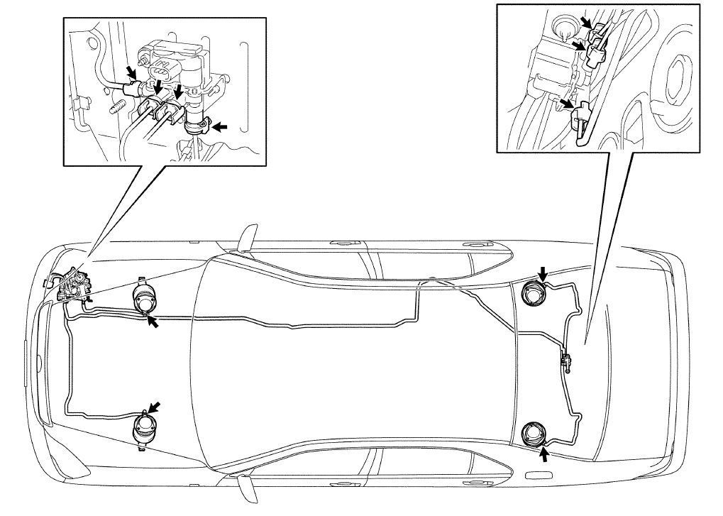

The LS430-UL has an automated air suspension system. It has an air compressor to supply air to the 4 air shocks via independent control valves. The air suspension ECU receives input signals from the 4 height sensors, and based on these inputs, it sends output signals to these control valves to adjust each air shock (either by adding or venting air from the air shock) to keep the vehicle level. The air line for the rear air shock is shown (see white arrow) below...
Here's a sketch of the various components of the air suspension system...
