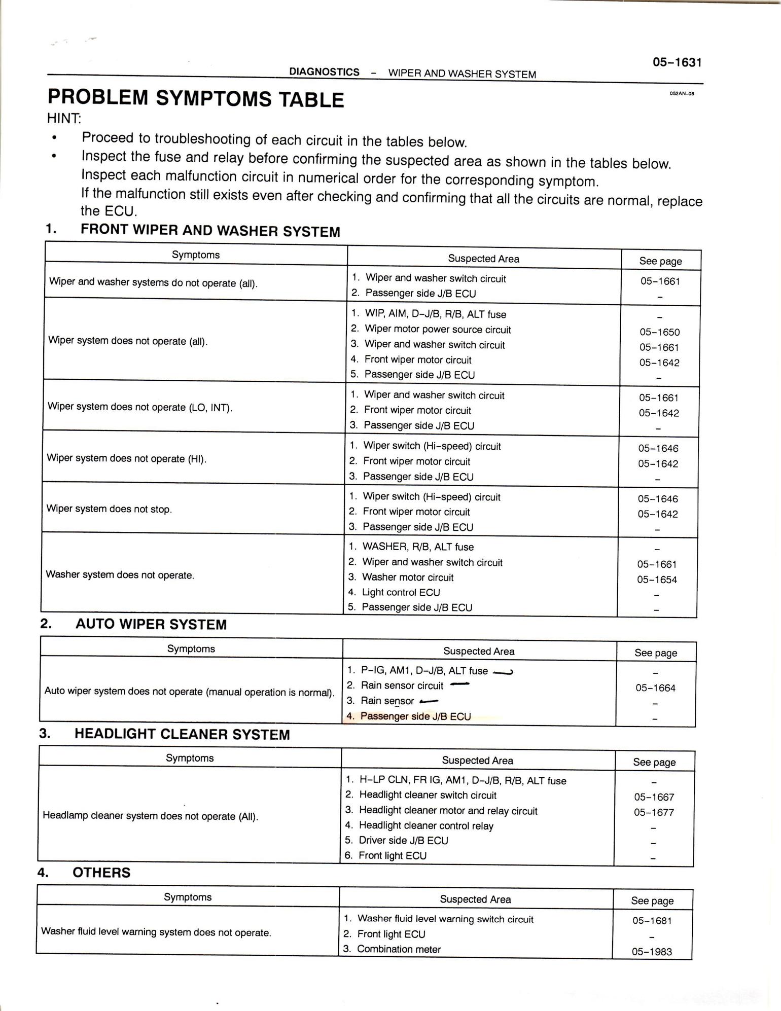

So my 04 LS430 auto rain sensor operates only in intermittent mode. It swipes twice when activated and then intermittent.
Lexus diagnosed it as follow
1. P-IG,AM1, D-J/B, ALT fuse (not sure what all that is)
2. Rain sensor circuit (they said okay)
3. Rain sensor (Installed NEW Lexus rain sensor with NEW Lexus Gel Pad recently)
4. Passenger side J/B ECU (its $866 plus two hours to install!)
I'm down to item 4 they said. There was some mention it might be the aftermarket FY windshield but highly unlikely.
I've reset the ECM by disconnecting the battery for 15 mins and to no avail. (if that's even how you do it)
The rain sensor when played with acts funny at times and will speed up and slow down. Removed from the windshield make no difference.
Actually I'm thinking its still the way its hooked up and possibly a bad wire at the rain sensor.
How many experienced LS430 owners agree with Lexus the passenger side junction box ECU needs replacing? Part # 82735
This is the last issue I have to fix.
Anyone?

What I'm hoping is someone might have the actual troubleshooting procedures. I don't trust my Lexus dealership.
My own thoughts on this are;
- IF I was to disconnect the rain sensor from the window and the four pin jack, how would the system operate to narrow down the problem? Would it still swipe twice, (mine will still swipe twice and sometimes only once when selecting "AUTO" and still act like intermittent wipers instead of rain sensing.) Would someone elses not do anything at all? This might indicate the issue is not in the rain sensor.
- Does the 4th step above mean the problem is within the passenger side JB ECU and could be a fuse or even something else? I shouldn't have to replace the entire thing I would think, I'm not throwing any codes and no other system malfunctions are showing.
- And the dreaded windshield replacement haunts me like a bad cold. Others have said this had no effect on theirs. It could be and I'm trying to figure how I might get insurance to replace it. Plus the dealer Premaplated mine.
- Anybody replaced this Passenger side JB ECU? Wonder if a used one would work?
Should be a way to further test this I think.
Thanks

"Whoa" hold on there. I'm not sure I buy this whole non OEM window and the rain sensor won't work. I don't believe there's anything magical about a "Lexus" window vrs a non OEM replacement window. In my case a "FY" considered good enough to be a BMW OEM window. However, Genuine Auto Glass who does work for Lexus said its a possibility. It just seems so improbable. And how can you tell without first having to replace the windshield this would be a fix?
However with that, I'm willing to give it a shot once I truly rule out other possibilities.
I think my problem is intermittent. Playing with the NEW SENSOR and or a combination of starting and stopping "AUTO" IT STARTED WORKING PROPERLY. I cannot seem to duplicate and restore full function.- and It would only swipe when I sprayed water on it. When I turned off "AUTO" and back on, it went back to double swipe and intermittent operation.
So any thoughts on troubleshooting such as if I remove the rain senor off the window and turn on "AUTO" it will act strictly as intermittent with no initial swipe upon selecting "AUTO. With the sensor connected, it goes back to a double swipe when activating "Auto" and be intermittent. I understand this behavior indicates a malfunction? But WHAT? Relay? Bad wire? Windshield?
Anyone got the pin voltage readout for a 2004 LS430?
If I can just get this fixed to satisfy my OCD, I'll be set.
