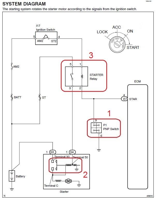

If you can can turn the ignition switch to the "START" position, then the problem is not with the FOB. That said, the 3 main causes for "nothing" to happen are:
1) The PNP switch is defective, misaligned or has a poor connection. This switch is adjusted such as the starter will operate only when the shift lever is in "P" or in "N".
2) The starter solenoid is defective, failing or has a poor connection. The starter solenoid is a magnetic switch which provides power to the starter motor and thrusts the starter gear forward to engage the flywheel to turn the engine.
3) A bad starter relay can also exhibit the same symptom as you described.

Next time you experience the "nothing", try moving the shift lever to "N" and back to "P" to see if the starter would move.
