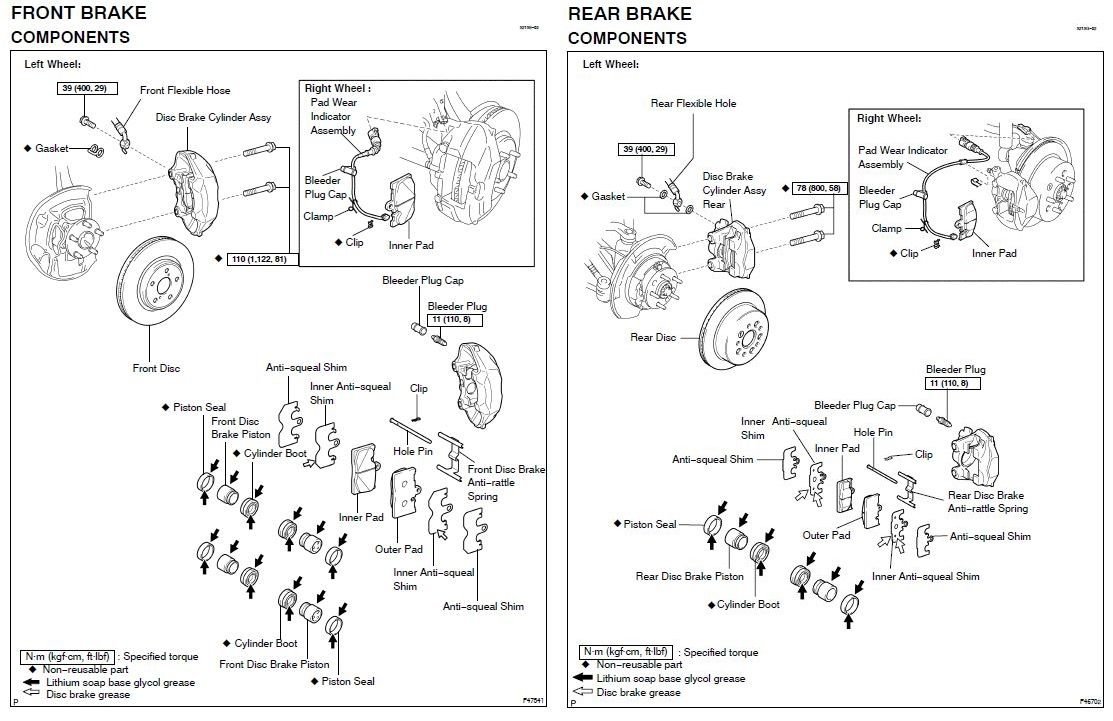

The first video shows him putting lubrication on the two caliper bolts. That's a really big mistake on aluminum bolts. The torque spec on those bolts is for a dry thread. Putting lube on the caliper bolt threads may result in over-torquing and stripped threads. Lexus recommends replacing those bolts as they are spec'd as one-time use bolts.

Please see below the proper torque specs, locations to apply grease, and all the non-reusable parts.
