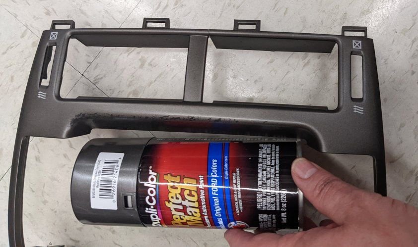

I just spray painted my Nav bezel last week (March 2022).
I used Dupli-Color BFM0360 Dark Shadow Gray (CX) Replaces T299 0-26916-71408-4
Pic 1 - Original bezel as in car when purchased (Oct 2021):
Pic 2 - Spray Can Match:
Pic 3 - Spray Can Label:
Pic 4 - After cleaning with rubbing alcohol (Obviously do not do this as it attacked the existing good paint):
Pic 5 - Installed in car today:
