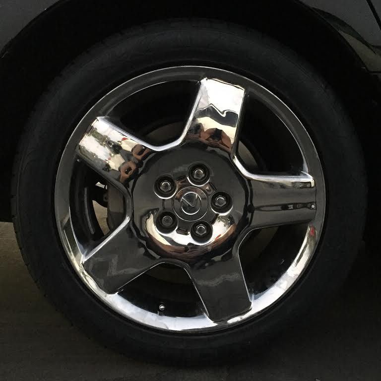

-I bought all new tires today at Trusted Tire Service
-Big thanks to Jesse and Danny at Trusted Tire Service for the hook up.

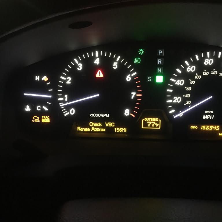

This sensor came on the other day CHECK VSC
-I checked the code and it was giving me code P0446 and P0441.
-I bought a new gas cap at the Lexus dealer for $32.12
-Problem solve
-Big thanks to rkw77080 and Legender for the help
P0441 = EVAPORATIVE EMISSION CONTROL SYSTEM INCORRECT PURGE FLOW
P0446 = EVAPORATIVE EMISSION CONTROL SYSTEM VENT CONTROL CIRCUIT
These codes are often caused by a loose (or leaky) gas cap. Try clearing the DTC's and tighten your gas cap to see if this will address the problem.

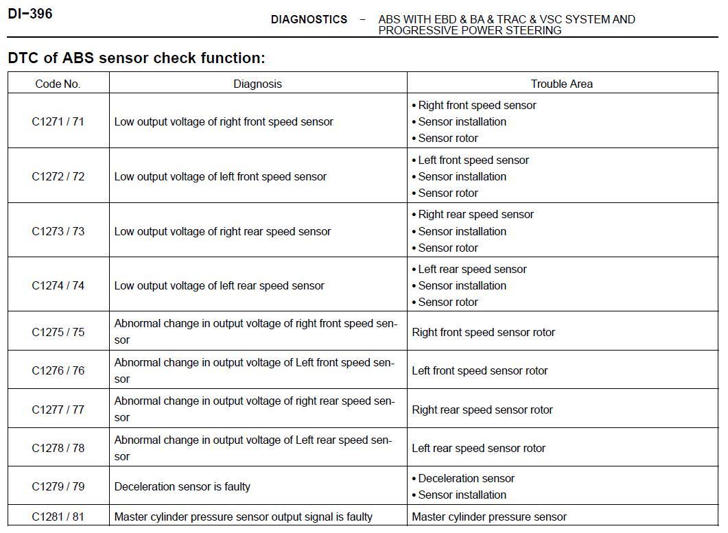

Please note that there are 4 types of OBDII codes:
• P = Powertrain
• B = Body
• C = Chassis
• U = Undefined
So, P0441 and P0446 are DTC's for the Powertrain that caused the "Check Engine" light to come on. They probably had nothing to do with your "Check VSC" (Vehicle Stability Control) light.
The "Check VSC" has its own set of DTC's, which belongs to the "C" group as follows:
Most OBDII readers can only read the "P" DTC's, and cannot read the "C" DTC's.

Yes, just make sure you twist the gas cap on and hear a few clicks to insure you get a good seal. Next thing would be to try an new gas cap. That's the easy stuff first.

New tires for my LS430 today

THANK YOU FOR YOU HELP! just got a new gas cap.
