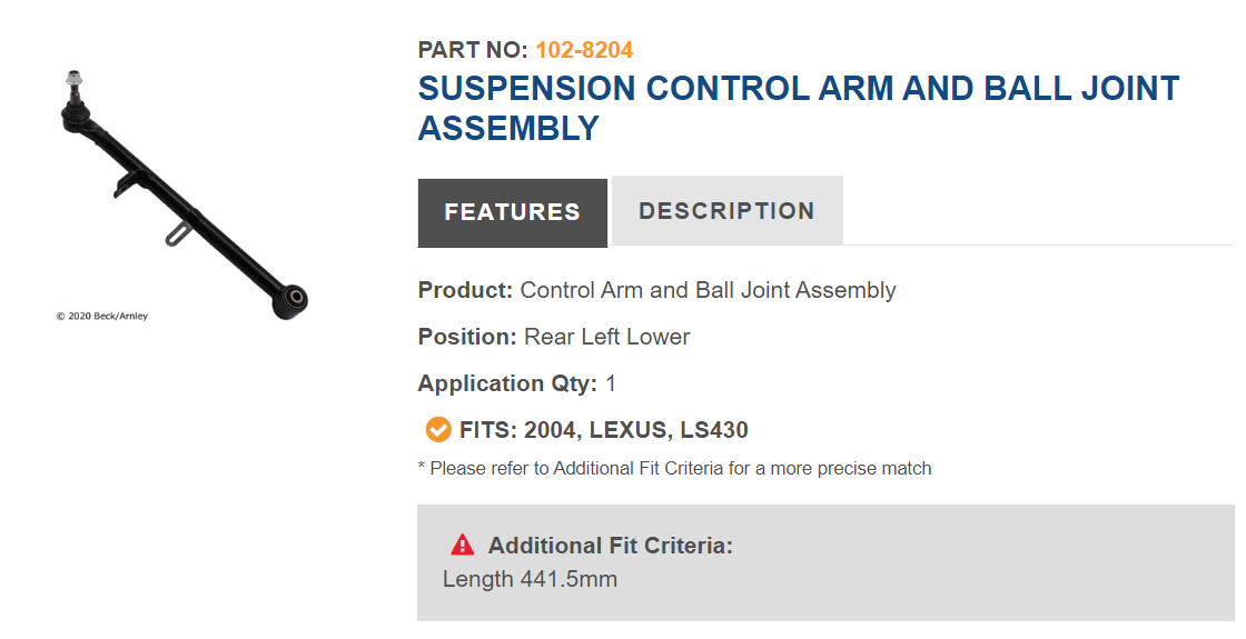

Originally Posted by pmesfun
I have the shorter arms, but the actual fix is new springs like Striker said. It brought camber back into spec. Beck Arnley makes the shorter arms now, so it would cost half of the OEM arms I used.
Originally Posted by Johnhav430
Great info!
edit wow $42 each. Any point in installing shorter arms, or springs only (they are $43)?
https://www.rockauto.com/en/moreinfo...32014&jsn=1286
https://www.rockauto.com/en/moreinfo...32014&jsn=1309
How are you verifying that these are the shorter arms? I can't seem to find conclusive evidence. I could be missing something.

they only make the shorter length.
Is there any place I can go to verify that info? Didn't see.om the B&A site that confirms the length. Sorry if I'm missing something in plain sight.
Old Feb 15, 2022 | 03:12 PM
pmesfun's Avatar
pmesfun
Joined: May 2010
Posts: 550
Likes: 172
From: DFW,TX
Old Feb 15, 2022 | 03:17 PM
pmesfun's Avatar
pmesfun
Joined: May 2010
Posts: 550
Likes: 172
From: DFW,TX
Does your car need shorter arms? Just FYI, you lose some suspension articulation with them, i.e. slightly stiffer ride.
Old Feb 15, 2022 | 03:18 PM
eelliiss's Avatar
eelliiss
Posts: 70
Likes: 22
Awesome, I totally missed that. It was, indeed, hiding in clear view.
