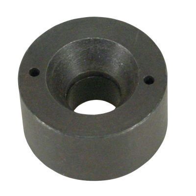

If you don't have one of these, i would highly suggest picking one up, it will reduce the effort needed substantially: I have air tools, but i still install my studs by hand with it
It's simply called a "lug stud installer" and I just picked mine up at a local autoparts store for less than $20. It is basically a bearing which allows the outer cone shaped surface to rotate separate from the bottom half which will be contacting the hub. It lets the lug nut spin free while it pulls the stud through, as opposed to it grinding against the hub.
May seem silly, but if you do your own work like you are doing, it will come in handy again someday later.
Another thing that may help is to put the stud in the freezer overnight before installing it. causes the metal to contract and in theory, should help it slide in.
Thanks for posting this, I had no idea anything like that existed. I think ill grab one off amazon just to have around for future needs.
