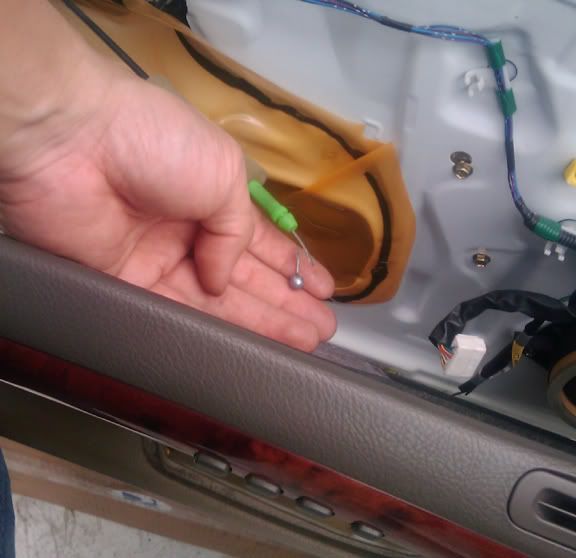

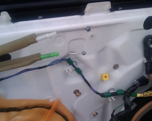

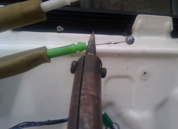

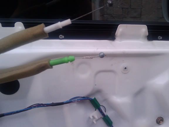

i had the similar problem with the cable snapping. i used a soldering iron, soldering lead, and thin guage wire to fix it. here some pics:
cable break
solder to link
wrap with thin guage wire
resolder to reinforce

How long has that soldered fix held? I would think the break would occur in a location where the cable is bent, which wouldn't lend itself to a solder fix.

The flex in the rest of the wire will not be affected so unless that specific spot needs to repeatedly bend it should be fine. If it is not subject to repeated bending the solder joint spot should hold forever.

The soldering has held up. Don't think it will ever break at the spot again. The cable does need a little flex. In the pics, that should be the thickest you should make it. The closer too the ball joint the more flex you need.
