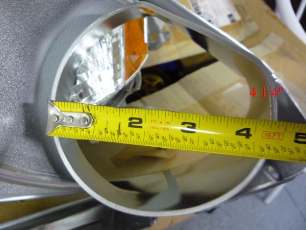

Trying to figure out if anyone knows the size of the non projector housing inside our headlights???
the one circled in red....Thanks

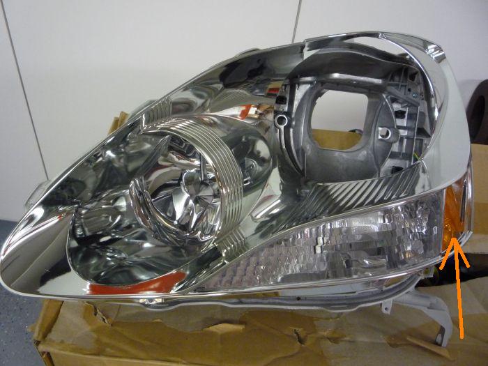

Pictures are up for others who may be interested:
From the backside, it's not a perfect circle. It's slanted towards the center.
Measurements from edge to straight edge: 3 3/4"
Measurements from edge to round edge: 4 1/4"
If you're in here already, you can remove that amber piece:

That's what I did when I took mines apart to paint the housing. I removed the amber and made a custom inner lens out of lexan.

The orange plastic lens have clips that hold them in place, not glue.
When you take them out, you need to replace it with another lens, such as the clear one in the picture.
They aren't that hard, but a lengthy process. You need to remove the bumper, so 9 screws on the bottom. 3 on the top, and 2 very hard nuts from the side of the fender.
After that they are just held by 3 10mm screws.
Takes about 45 min I'd say.
