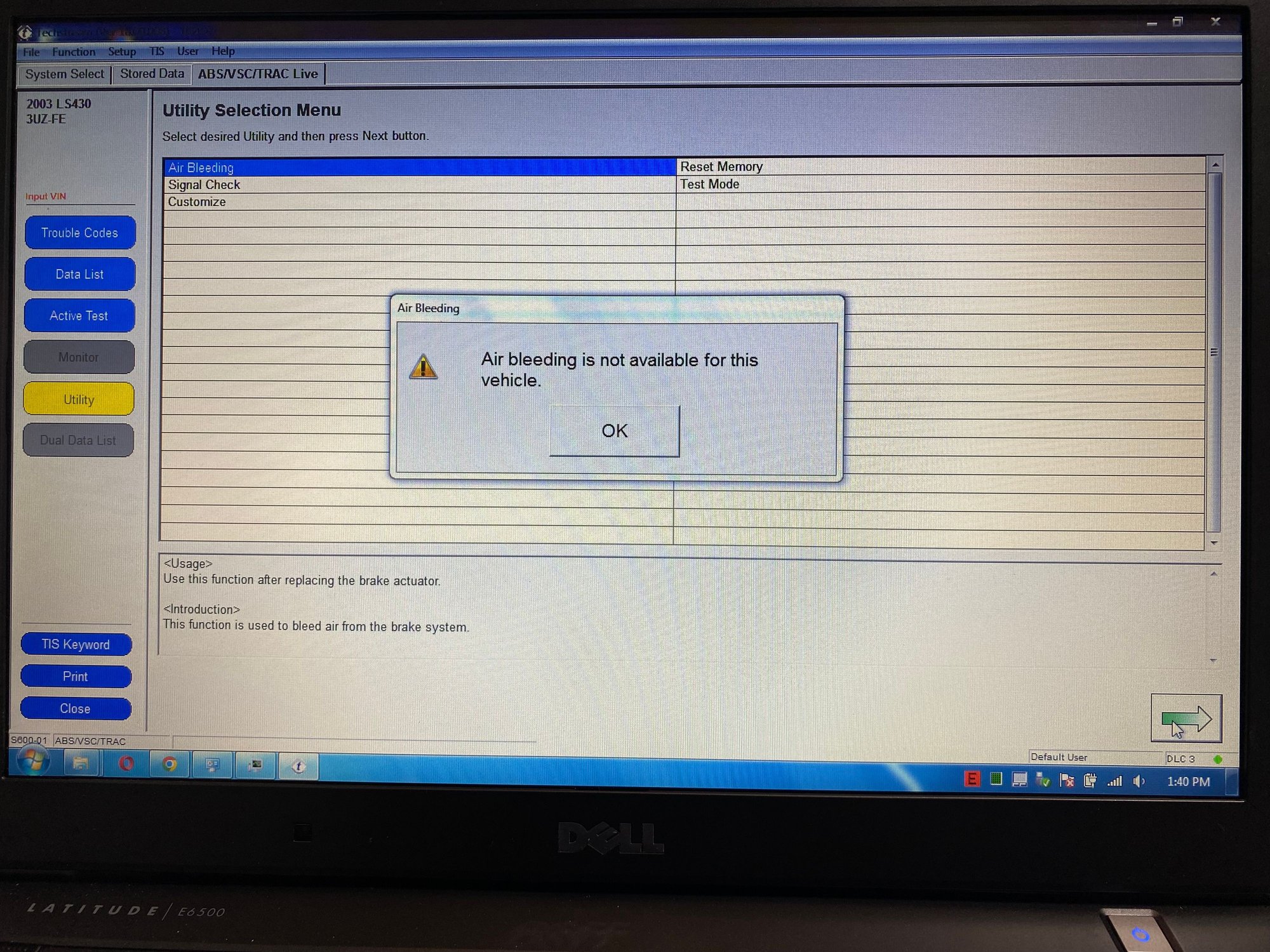

Old Jan 5, 2026 | 02:02 PM
Quinten's Avatar
Quinten
Joined: Aug 2009
Posts: 165
Likes: 32
From: NV
Just to follow up... I did finally get techstream working... never could get the VDIAG VCX Nano to work, the mini VCI I got from eBay worked fine. Techstream shows air bleeding is not supported on my 2003 LS430 UL. I did bleed the brakes and actuator several times with a speedi bleed power bleeder. Pedal travel is better and acceptable but still has more travel than I am accustomed to. I was able to turn off the auto tilt and DRL so that was nice. I'm wondering if the VXDIAG module I have may be defective?
