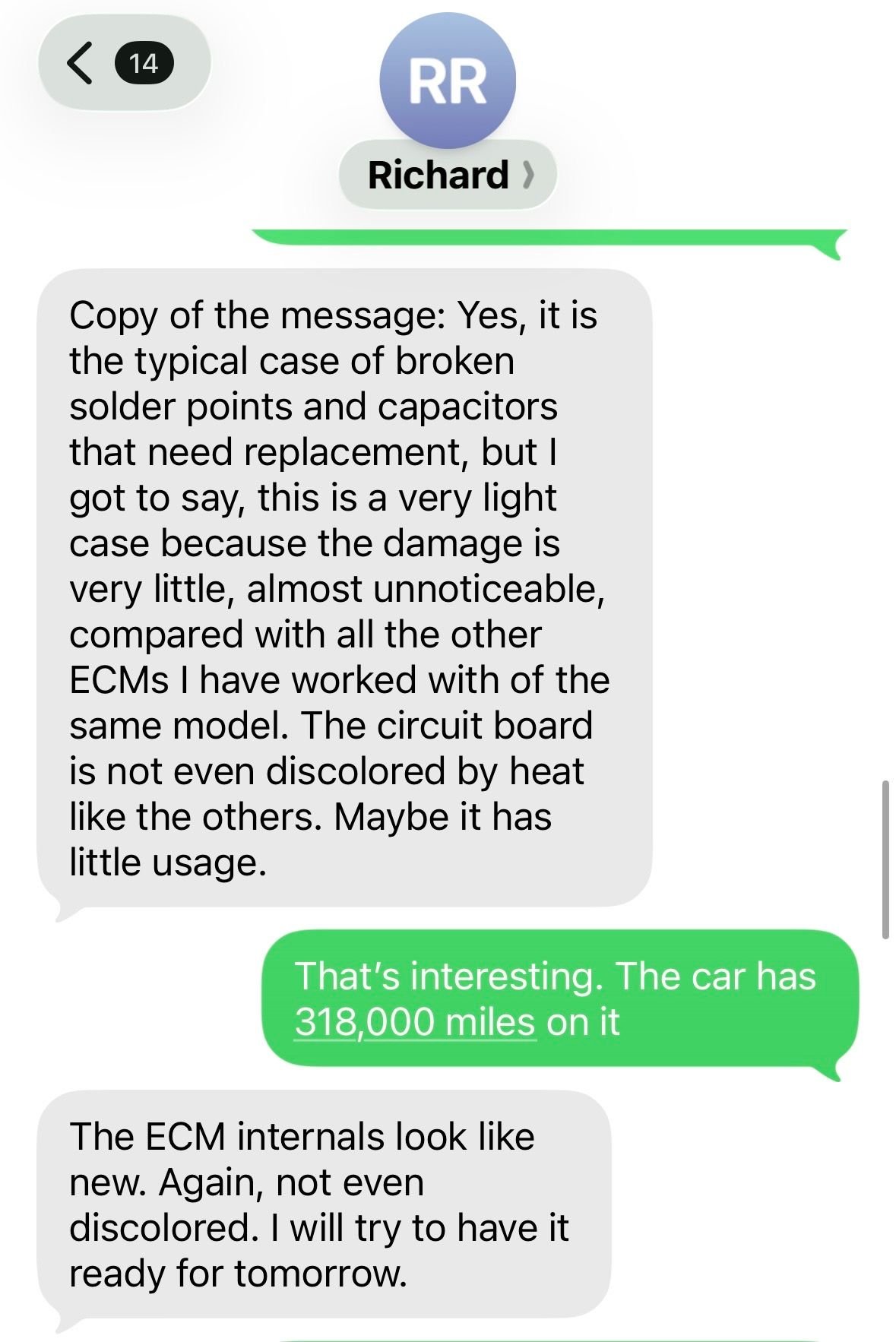

I’ve also sent my ECM to TechnicalDomain and he claimed he made some repairs but, who knows on that.

He claimed he replaced the bad caps and fixed bad solder joints. There was literally no change in behavior after putting it back in.

ECM repair from TechnicalDomain
