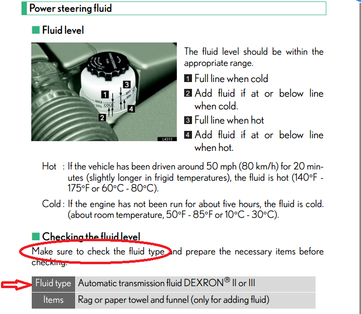

Be sure to use DEXRON II or III

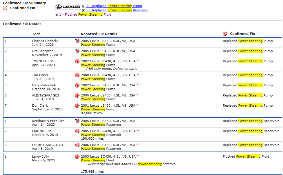

tammap, Can you explain what that printout is? Some Lexus database of repairs? I had dealer replace my fluid around 2.5 years ago, just because I never had before. My 2005 has 165k miles. The problem seem common, or not rare, but is it the pump that reeds replacing, or the reservoir? Is reservoir filter clogging the main problem, and should my fluid change help prevent, or does the reservoir need to get replaced at some point even with a fluid change? I'm wondering if there are proactive steps or if this is just age/mileage related. I'm not sure how expensive a repair is if this destroys the steering rack, (or is it just the pump), but I'd rather not find out. Thanks

I would try pulling the reservoir out and checking to see if fluid is actually making it through the filter. If not you could try cleaning it or replacing the reservoir. If that's not the issue then I'd look into the pump. As long as the rack has no visible damage and isn't leaking then I'd stick to looking at the reservoir, pump, and lines. That printout is just showing people's fixes for loss of power steering in these cars.

The printout shows a repaired database from Identifix of indy shops that share their vehicles's issues with the confirmed fixes.

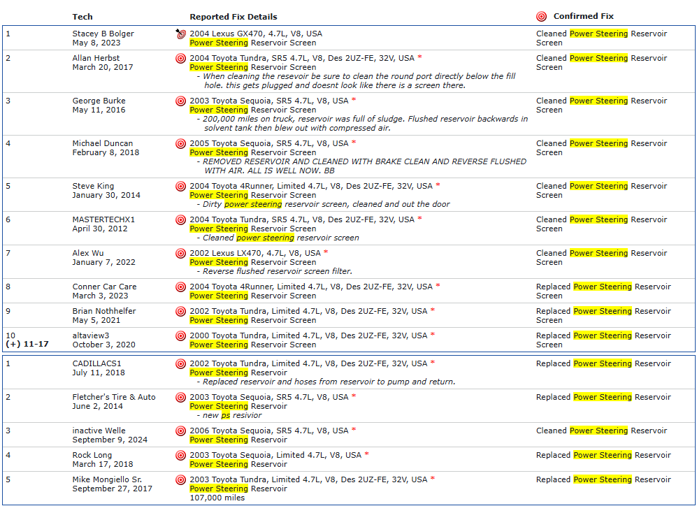

The P/S reservoir clogging is the main problem leading to P/S pump failure. A serviceable inline filter is an option to save time from having to clean out the P/S reservoir filter regularly.
The Toyota/Lexus P/S pump filter screen leaves much to be desired, see the attached
