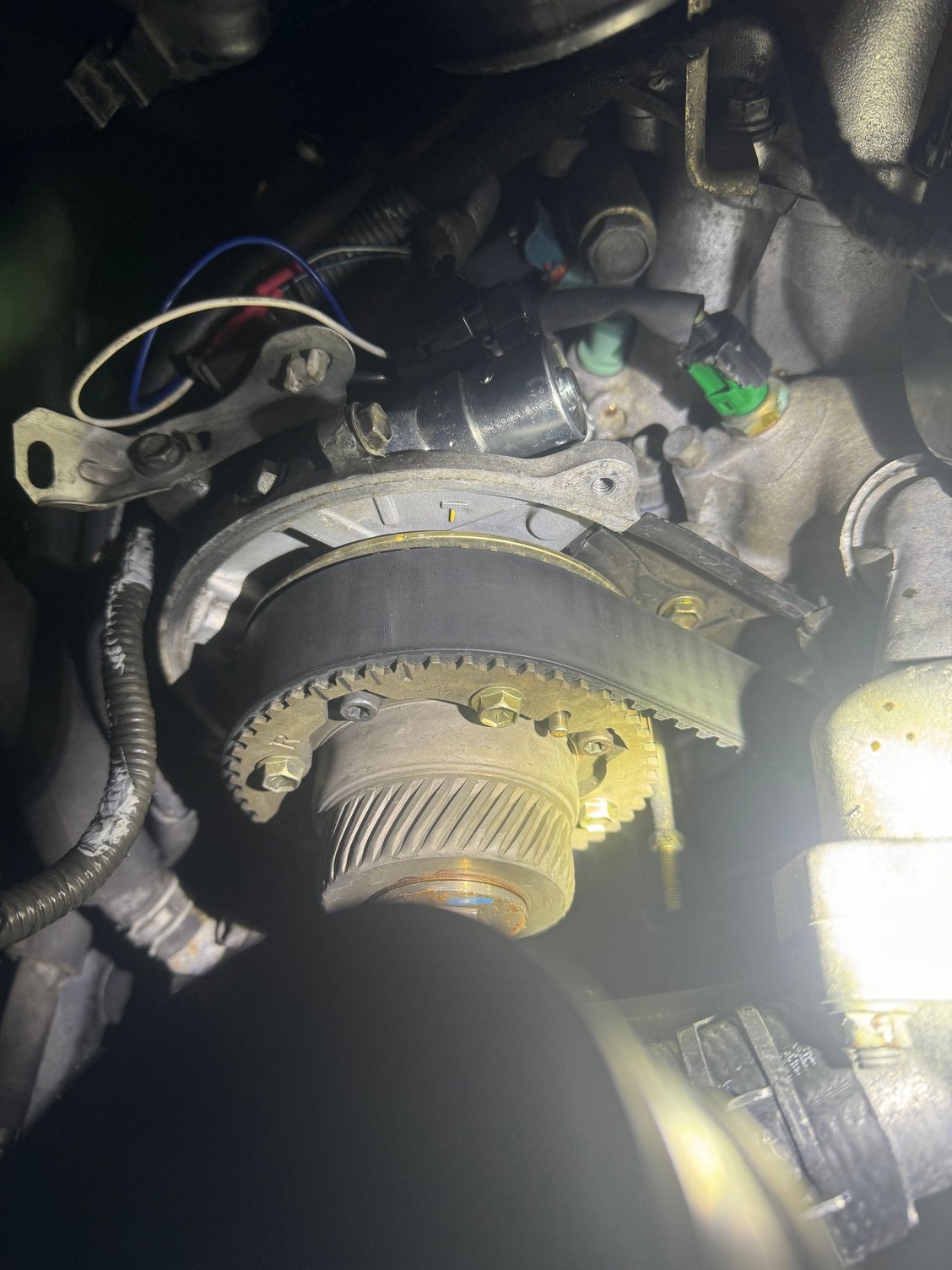

It's extremely surprising how little information there is on this issue I ended up replacing the timing belt setting everything right and replacing the ocv filter and the vvt cam gear on the passenger side NO CHANGE I'm almost certain I'm the only person in the world with this issue I have gotten a Toyota tech stream scanner swell and did Vvt active test both work replace the engine colant temp sensor and the ecu have 2 new cam sensor I'm putting in this weekend and I've replace the oil again and filter. What do I do next

Did you replace the entire timing tube assembly or just the sprocket?
