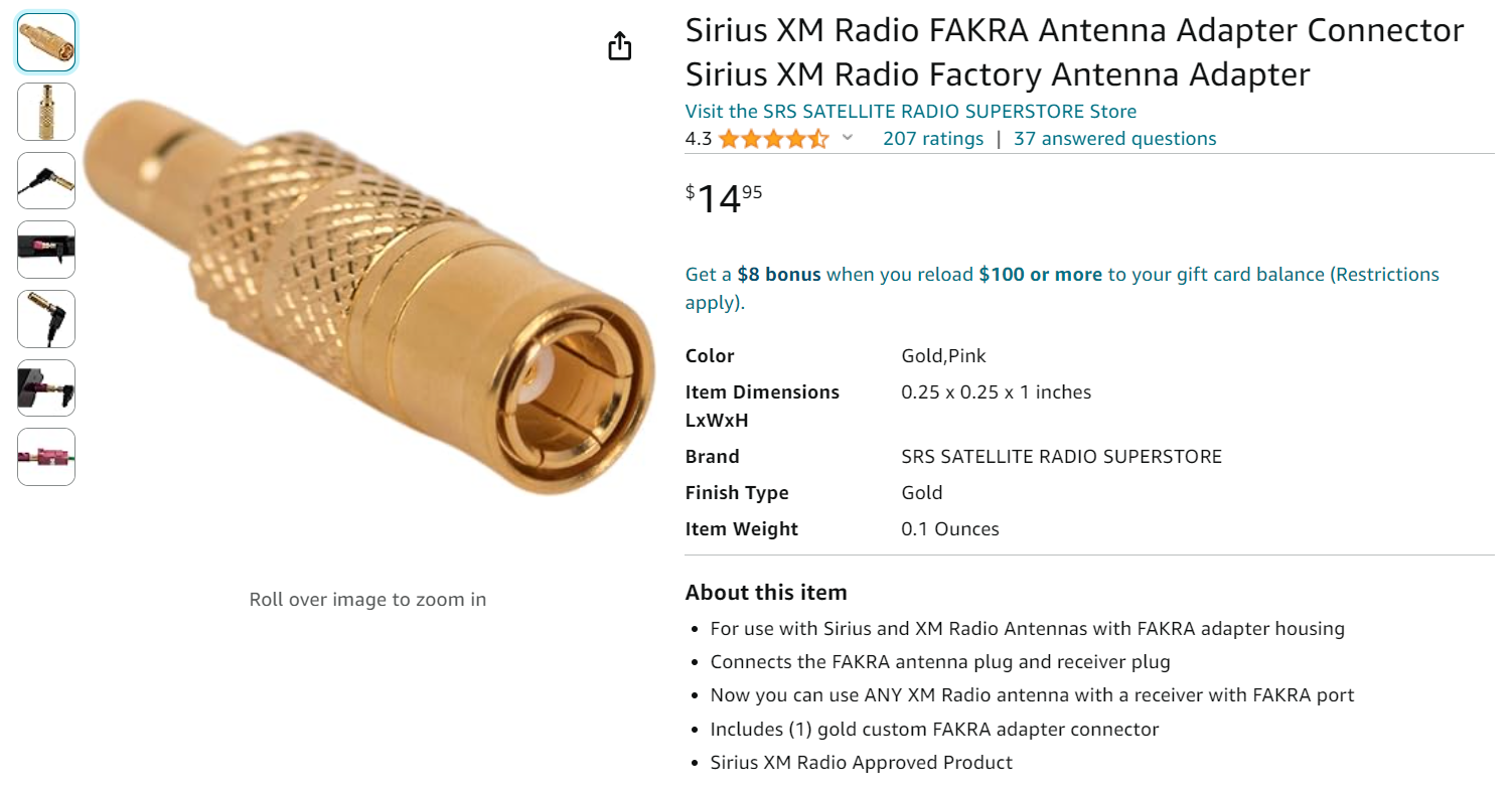

I can certainly sympathize with the problem.
I have a 2004 LS430 that I've had for nearly 20 years. Because of a minor parking lot mishap in December, the body shop replaced my trunk-mounted magnetic SiriusXM antenna. It's odd that the body shop had and used the Audiovox splitter that is no longer available, but the ends of the splitter won't hold fast to the inputs on the receiver. The SiriusXM radio works until I close the trunk lid, or drive, and then the connection is lost. I've tried all types of solutions, but none will work for more than few minutes. My next try is an antenna adapter that I've ordered and will receive next week.
Adapter & SiriusXM inputs

Hey guys try this. I have one as a spare and it also works great.
https://www.ebay.com/itm/186238113008?chn=ps&norover=1&mkevt=1&mkrid=711-117182-37290-0&mkcid=2&mkscid=101&itemid=186238113008&targetid=1531876740478&device=c&mktype=pla&googleloc=9004231&poi=&campaignid=19851828444&mkgroupid=145880009014&rlsatarget=aud-1480434320348la-1531876740478&abcId=9307249&merchantid=101991613&gclid=CjwKCAiA-vOsBhAAEiwAIWR0TaFb7AEB5zij482DVgtimKpiKGy_eV8OJ7XjETxsGtKm-OOKVqfchRoCTNQQAvD_BwE

Thanks. I've ordered it and I sure hope it works. I know it's kind of a first-world problem, but SiriusXM is the only thing I listen to in my car, and I've really missed it.
