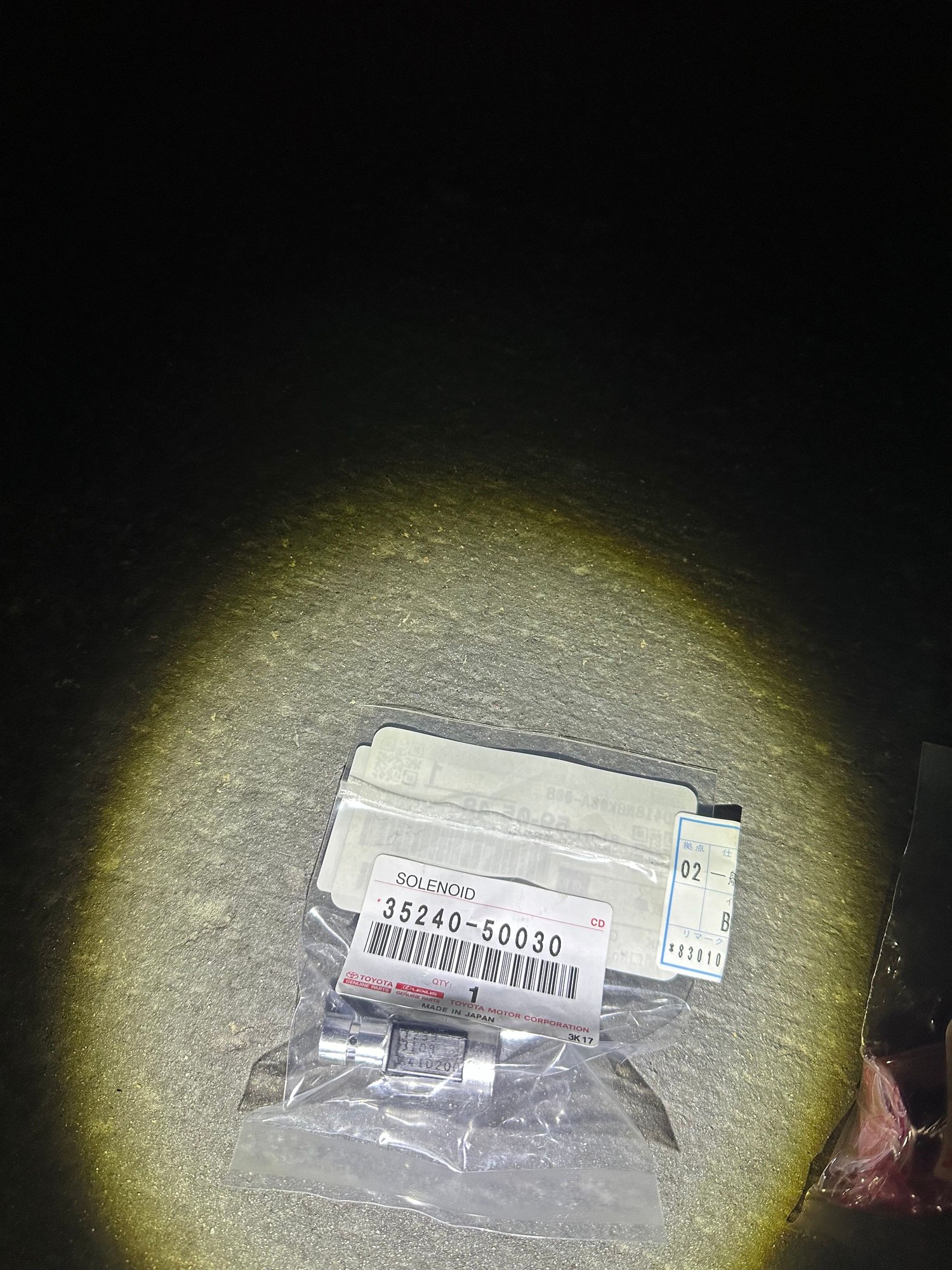

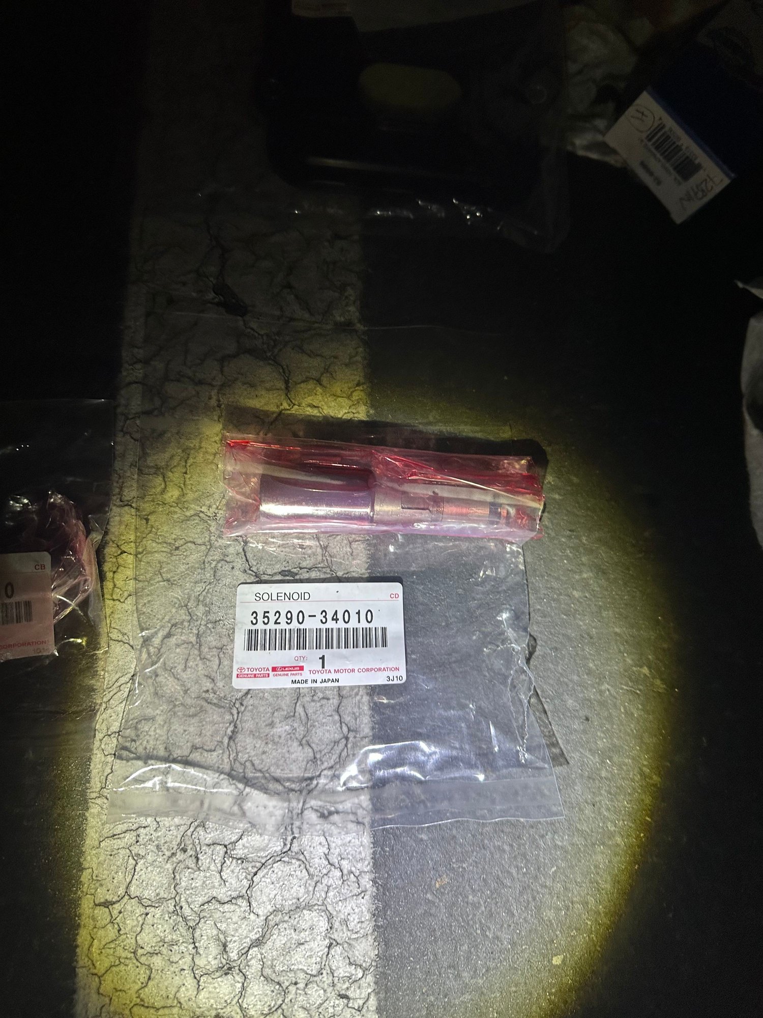

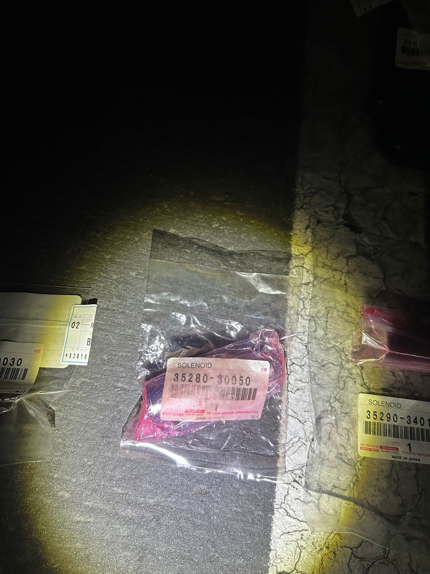

Alright guys, I did the job with mixed results. I replaced the SLU, SLT and S3 solenoids.

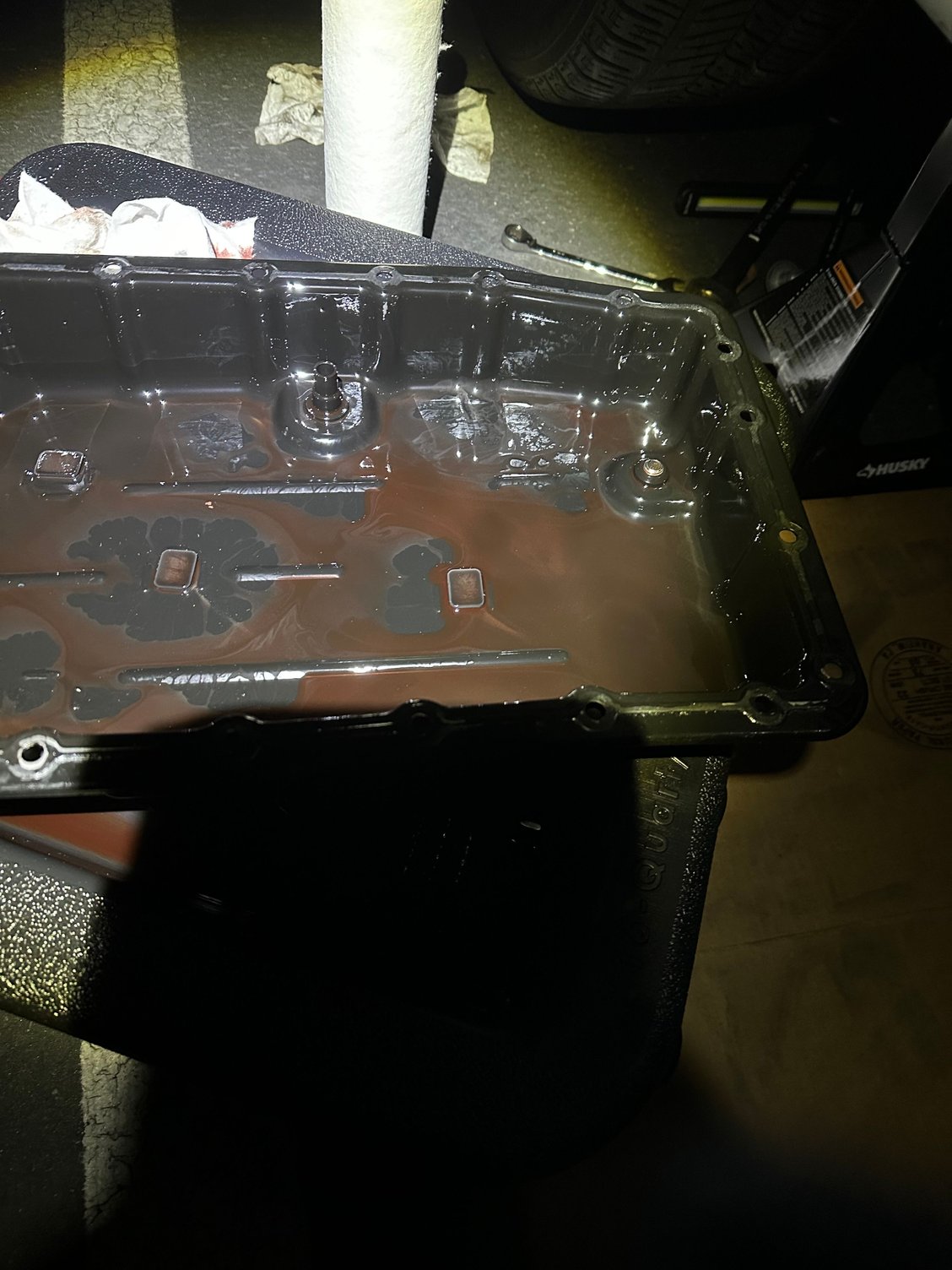

First off, I knew something was amiss when the previous owner took the car to a transmission shop and they stated that they replaced ECM, the strainer, and added 5 quarts of fresh fluid.

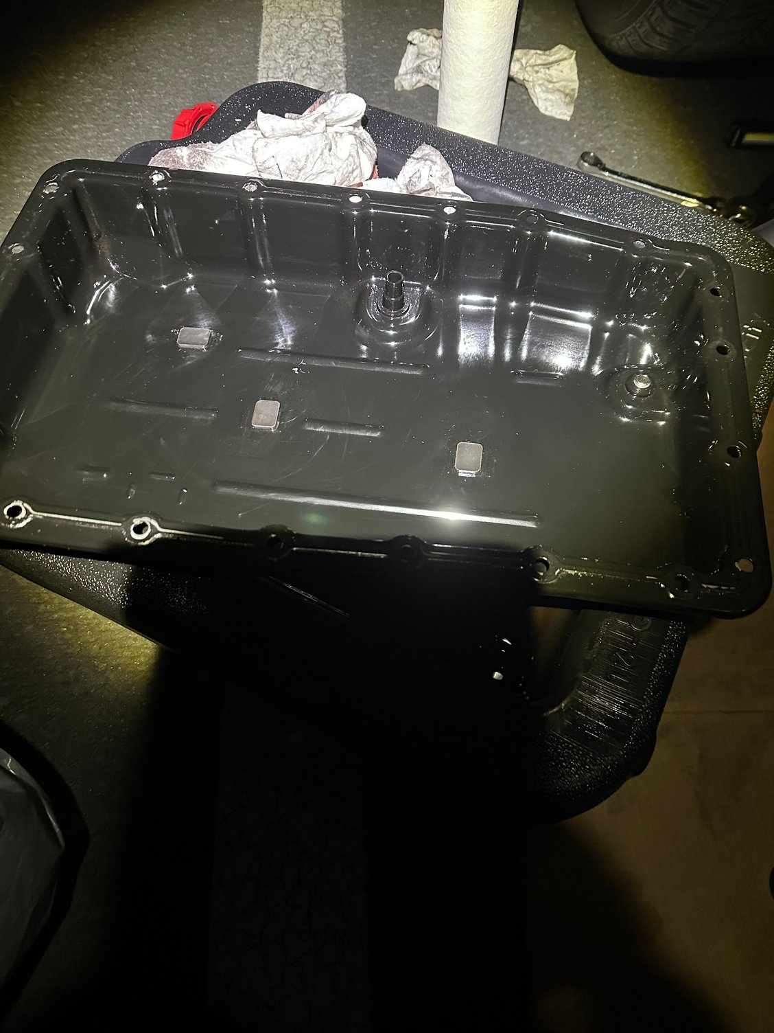

I call BS because the fluid was dark red and smelled old but wasn’t bpitch black it was over filled, 4 quarts was drained but. You can definitely tell that the fluid wasn’t replaced if ever. The strainer looked original as well, plus I didn’t see any remnants of previous work being done, like removal of the drain pan bolts or exhaust bolts being removed. And supposedly the trans shop did all this back in September of this year.
There were a lot of metal shavings on the magnets, again, I could tell the pan was not cleaned at all therefore the shop lied about doing the job. Stay away from ghetto shops please.

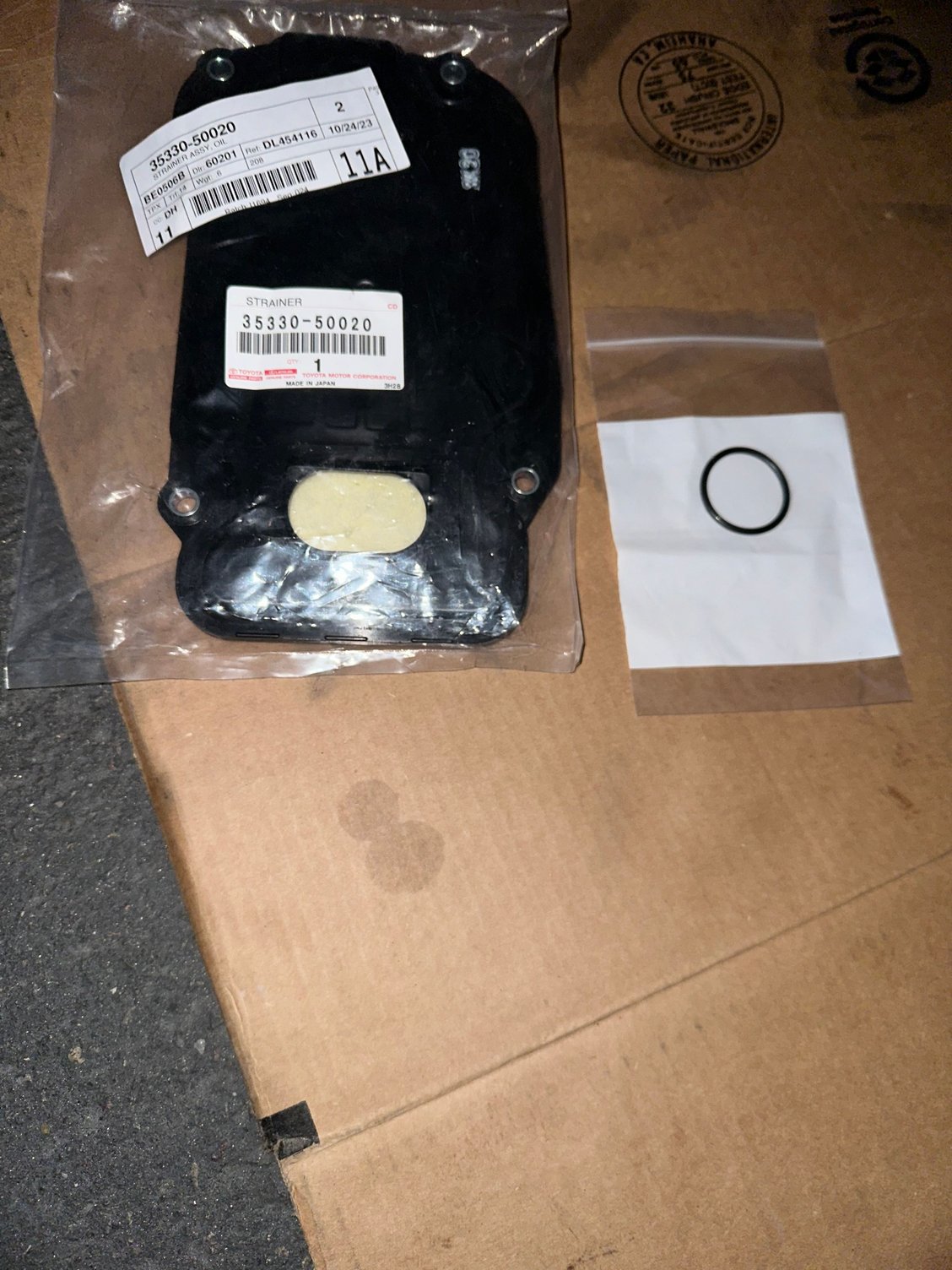

After replacing the solenoids, strainer, gasket, and adding about 2.5 quarts of ATF, I didn’t have time to actually do the whole drain n refill procedure since I just didn’t have time and my body was sore as heck from laying under the car for hours, so I simply added the amount of ATF everyone recommended, I will do the proper drain n refill this weekend to make sure the level is perfect.
