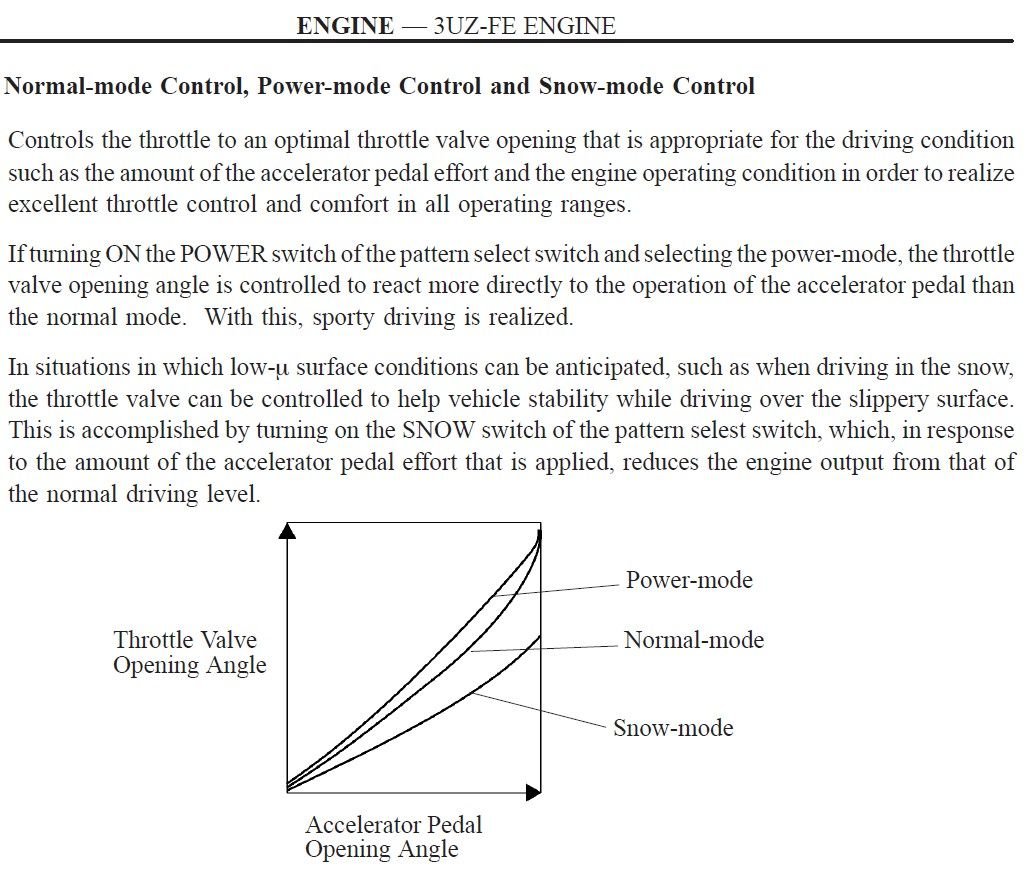

PWR raises the shift points and sharpens the throttle response. My better half calls it "Angry mode". <LOL>
SNOW limits wheelspin, softens throttle response, and I believe disables ABS below 20Mph. It also changes how VSC responds to skids and such.

LS430 Transmission Pattern Select
