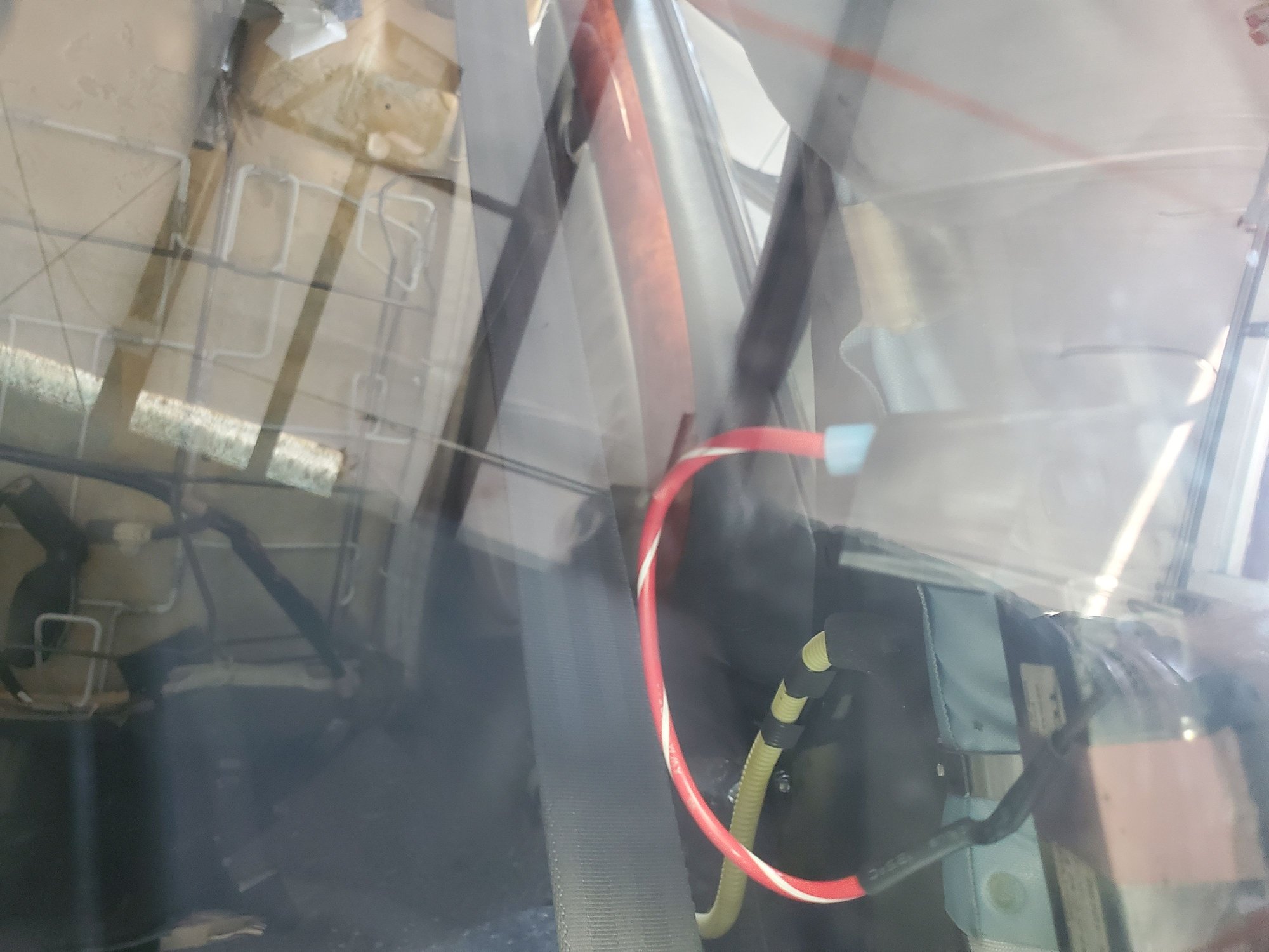

I got it to work. I pulled everything out again to take another look now that I understand more about it. The plug on the rear glass side was not the correct size for the car side of the antenna. I had to cut off the stock black clip, then did a quick test to confirm that was the right wire, and then made my own connection with spade clip. I had to trim down the connector on the window side to get it to fit on my spade clip but I got it all wired up with some shrink tube and everything worked like a champ. Attaching pictures in case it helps someone else down the road.
