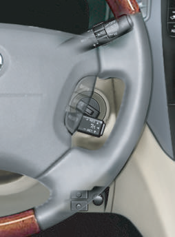

This may not be your issue, but doing the below will reset it, as you may likely already know....
Tire pressure warning system must be initialized after tires or wheels have been replaced or rotated, or after adjusting tire pressure.
Park the vehicle with the parking brake applied and turn the ignition switch to “LOCK”.
Adjust the pressure of all the tires to the specified level.
Turn the ignition switch on.*
Push and hold the reset switch until “Pressure Initial” appears in the multi-information display.**
Drive your vehicle for more than one hour or at speeds of 19 mph (30 km/h) or over.
If you make a mistake in the middle of initialization, perform the operation again from the beginning.
*:If “Low Tire” appears in the multi-information display, push the “RESET” switch for a few seconds and make sure the warning message disappears.
**:If “Pressure Initial” does not appear when the reset switch is held down, the system may be malfunctioning.
