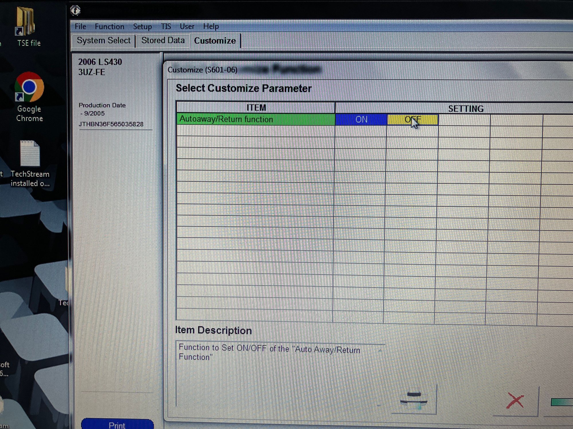

I just disabled that feature last week using TechStream on an old laptop. Setting up the software on an old computer took me hours. Making the changes on the car took me 6 minutes. Cable is cheap and software is free, but you need to be on an old version of Windows.

You can get Techstream working on Windows 10.
I have mine (version 12) running on a Win10 laptop.
If I remember it does require some Windows Registry tweaking and a driver install.
I disabled my Autoaway about 3 years ago.
