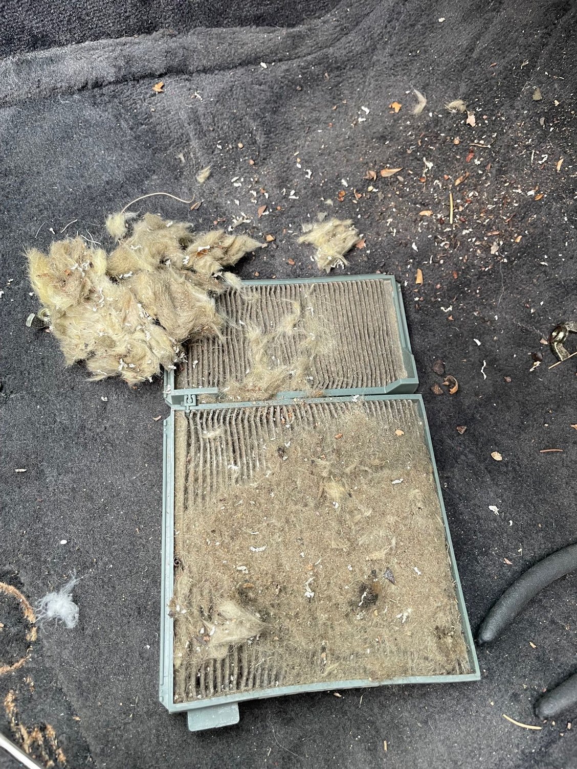

the air filter was pretty dirty, and the cabin filter was VERY dirty

Did you find the rodent that was living in with your cabin filter? There's no way that much insulation could get in there unless something put it there. That is one of the dirtiest I've seen in any car.
Is there a date on the ECU when it was "remanufactured"? My old 94 used to stall like that after driving 15-20 minutes and then finally wouldn't start at all. When I took out the ECU, one of the caps was burnt right off the board and was just rolling around inside. I put in another good ECU and it was fine. (Til that ECU went bad) Might want to have a professional take a look at it.

ha i wasn't sure if that was dog hair or insulation!
there's no date on it, but it looks pretty clean inside, no burns or anything. i'll search but let me know if there are recommended places to get them rebuild, or buy a new one. thanks
