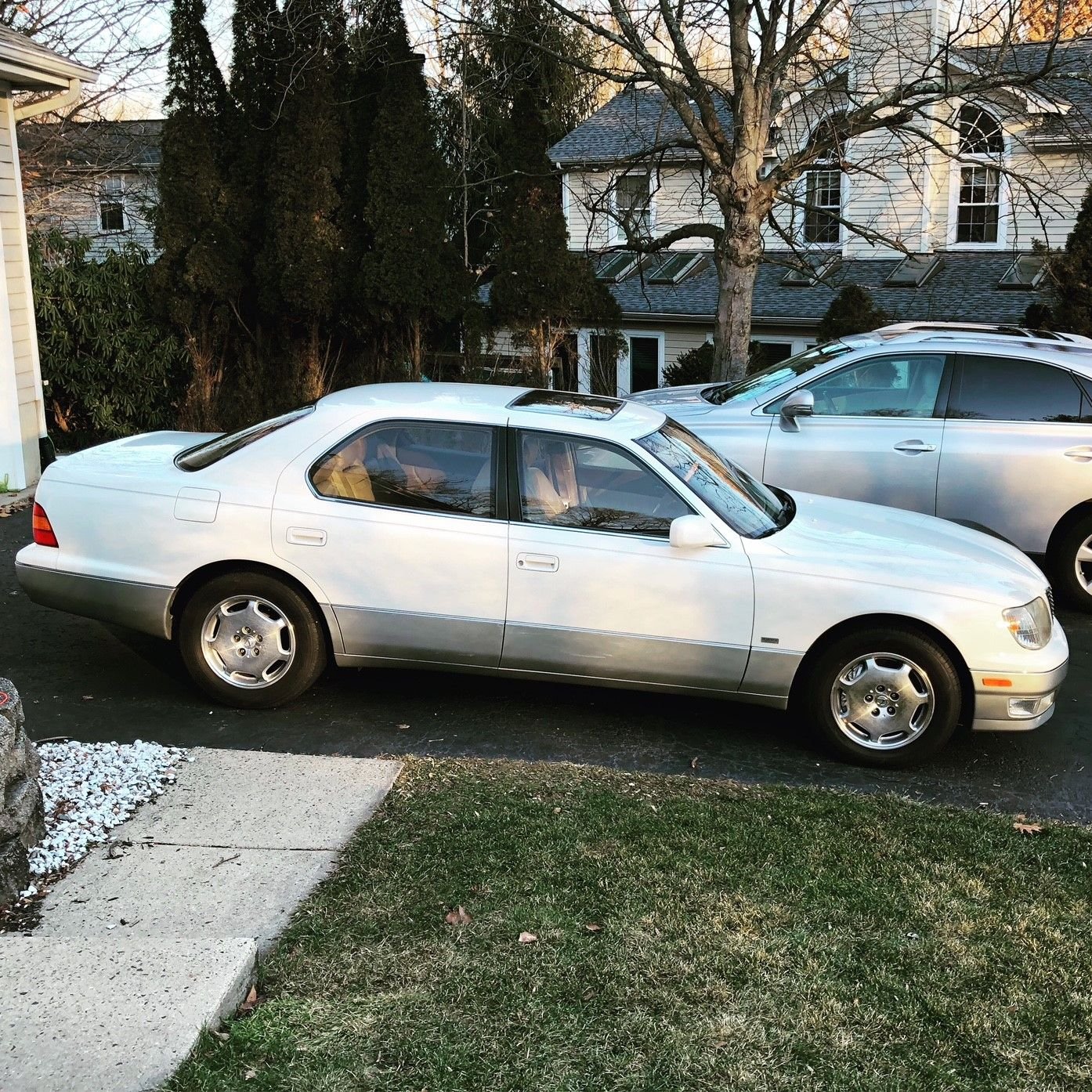

Hi everybody-picked up a beautiful 00 a month ago it has a lot of clunking going on with the front suspension. Any recommendations for good Lexus Indy shops or reputable dealers to work on this?

congrats that is a beauty!

I have the same year car, and the same color, with the same kind of rims too lol. We would be twins if I parked next to you. It's hard to acknowledge one clunk from another clunk in text. I can my share my personal experience with you. My car has less than 150K miles. Of course I drive on California Highways, not on New Jersey roads, but, I had clunks a lot I personally noticed with my drivers side front wheel area. It really was hard to pin-point but it seemed like something going on with suspension parts or something. It was an audible snapping maybe clunking noise especially when slow turning. What kind of tipped me off was I was stopped, got out of my car, then sort of turned the wheel a bit, not moving in Park, I pressed the brakes and I actually heard a little bit of clicking just from pressing the brakes not moving. So, I took off the front wheel, removed the brake pads, they looked fine, but, then I looked again after a bit I noticed one side of the pad was worn just a little more than the other side on the other end. So there was an uneven wear condition. So, then it's like okay what caused that because that's not normal. So, what I did notice is I don't like how tightly the pins feel when I have to slide them through to get them in place it seems like there's a strain to align it into place. I know that might seem weird but that's the best I can describe it. I don't know why it's like that exactly or what exactly I can attribute that too. So what I did is clean brush the guide pins that hold the brake pads in place, and lubricated all contact areas. I put new pads in also. I put it all back together and the noises are gone. Now I could swear previous to what I knew there was something wrong with my front end but what I did fixed it. It's like the pads were too tight and catching on the pins on one side especially. They really should not be like that. It's either like there's a possible issue with the manufacturing of this particular year caliper maybe some got past QC that were a little off, or, it is possible that it could be something else. My brakes have and had no issues with functionality, just were the cause of clunking and clicking noise that I could swear was a ball joint or stabilizing rod or something like that. So that's my experience, not saying it's your issue but I would certainly look before I spent, and find out exactly what is wrong. It's like I could have paid someone to replace my lower ball joint, still would not have fixed the clunk and clicking noises. So proper diagnosis is a big deal, will save you a lot of grief and money.

And mine is also the Platinum series too lol, same car!
