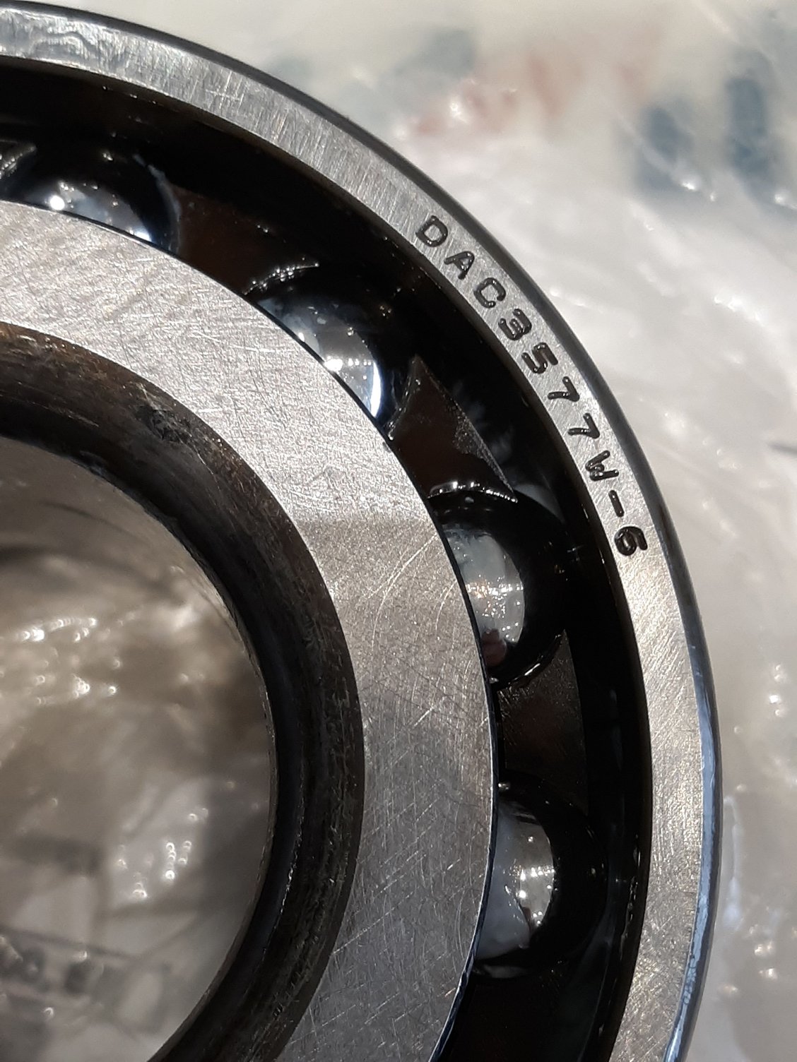

Here are the Koyo bearings I bought off a seller on Amazon for my 97'. I believe they're different than the 98-00 models however. But this serves to show you that it does come with a seal and isn't open.
sadly I learned about koyo after the timkens were installed. But price wise it came out to be the same with seals and bearings
As far as I know it is same 1995-2000.
This appears to be a better part.
Can you post a close-up image of the P.N. from the bearing shell

I'm ready to learn something new here, but ...
None of the bearings I see in the preceding posts appear to have seals. Those might be plastic shields or cages, but they will do hardly anything to seal the grease in and the dirt out.
Bearings are made with varying grades of tightness of seal (specified as "light contact," etc.), but none of the bearings I can see in the photos show anything qualifying to be called a "seal" of any type.
It seems the sealing function in this design is done by a separate part as shown in post #7.
So as long as the different cage / shield design on the replacement bearing does not interfere with the separate bearing seal, then I would not be concerned.
