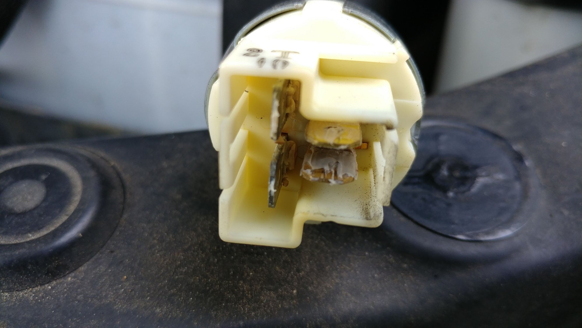

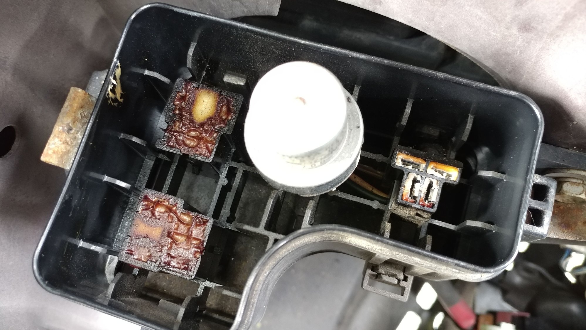

Here is what i found after removing headlight. What exactly should i be cleaning up. The grease ? Thanks for your help.

cleaned up the grease from the relays using a qtip. plugged them back in but the fan never kicked on.
not sure what my next step should be. Do i assume that the relays are bad or could it be a bad fan ?
its 80 degrees outside this morning and my temp using an OBD tool is showing between 192 and 196 degrees. Is this temp to high ?
thanks for any help.
