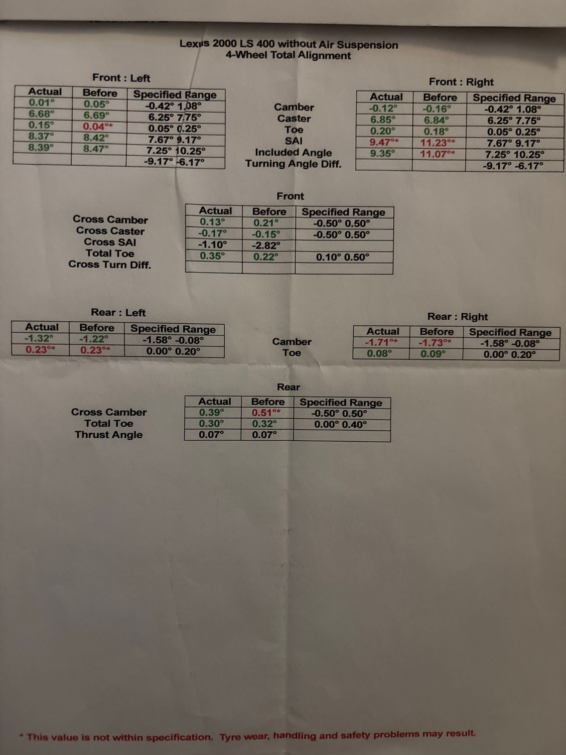

For past 9 Months I’ve replaced most of my front suspension parts:
LCA(Beck Arnley)
Strut Bar(OEM)
Inner tie rods(Beck Arnley)
Outer Tie rods(Moog)
Sway Bar bushing/end links(OEM)
And even Engine/Trans mounts(OEM)
also changed out Rack and pinion bushings(OEM, Passenger side only because the driver side is too difficult for me, I have arthritis lol)
Purchased OEM size new tires and rebalanced and multiple alignments throughout 9 months.
despite all this, the steering feeling is still a little loose, Driving in a straight line and when braking/slowing to a stop the steering wheel turns right, weird vibrations on freeway speeds, and when finishing a turn at low speed the steering wheel will maxed itself out whichever direction I’m turning to. It was so frustrating and annoying, spending money and time to an issue for so long😡
And the entire time the issue was… Alignment. Made no damn sense but I’m so glad it got fixed
My alignments in the past was done by a major automotive repair franchise, and another through a friend that has an access to one(German Car brand)
Just to be clear I’m NOT bashing or putting down the places or people I’ve got my alignment done but rather just spread awareness that the machine could have a problem I.E broken or not calibrated correctly as my latest alignment tech said when given the spec sheet. The main reason I didn’t think it was an alignment is because of the sheet of paper that tells me it’s all green, that’s my fault but what do I know? I’m not a mechanic or a technician, the car is 25yrs old;
Long story short, ALL my suspension woes were fixed, even found out one of my new tires a defect🤦‍♂️
So if you were experiencing issues although you’ve replaced parts it might worth to double check the alignment at another place or to a shop that specializes in suspension systems, the place I’ve went to also calibrated steering angle position.🙂🙂🙂
Alignment done from Major Retailer
When I brought my car to a suspension specialist in my area
After alignment was done
Last edited by ClassicLux400; Apr 9, 2025 at 12:25 AM. Reason: Changed first attachment because it named retailer

Alignment done through my friend.

Can confirm - I agree that the car is extremely sensitive to alignment and setup. Especially when it comes to steering feel, the weight of the steering, the ability for it to return on-center and how the steering feels when at high degrees of angle. I find the car responds quite well.
I personally prefer slightly more than stock caster and toe-in. I like the stability it provides.

This is the first car that made me feel burden because of what the steering/suspension was doing prior to this fix. Mind you I was coming from an 15 M3 and 18 A6 3.0T, so maybe I expected too much especially going into a 25yr old car that uses hydraulic PS vs Electric PS. But despite those newer cars before this, I felt more happy with this LS400, mainly because nobody trying to race me or try to tailgate me LOL. Anyway the new place also did a strobe light wheel/tire balancing for me because apparently these OEM wheels are HEAVY HEAVY and uses some specialty type of measurement to eliminate(100% gone and smooth now)high speed vibration.

Posting this just proves the fact this car is extremely sensitive when it comes to its suspension. So anyone that has issues regarding how their steering or suspension feels, alignment alignment alignment.
