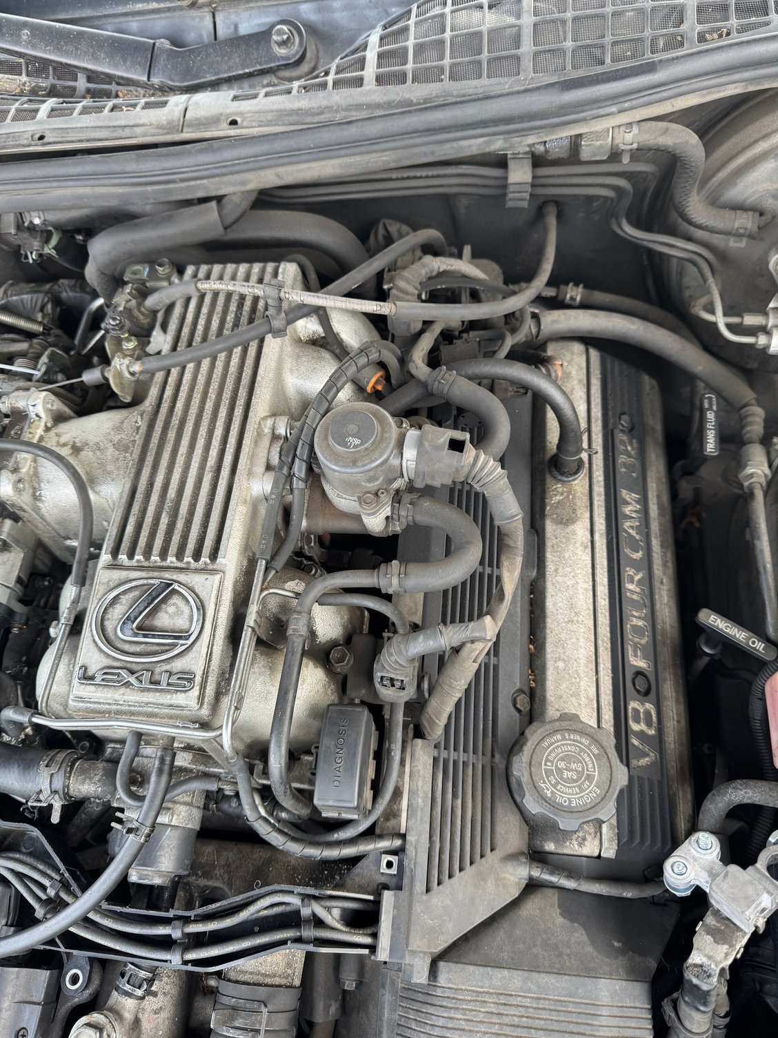

Got a code 71 from this 1993 Ls400 i recently purchased. Read through this forum-> https://www.clublexus.com/forums/gs-1st-gen-1993-1997/283263-code-71-egr-problems-read-this.html. But I am quite confused as I cannot find my egr vaccum modulator. I’ll attach an image of my engine where the vaccum modulator supposed to be, can anyone explain why I don’t have one there? Maybe I’m missing something but I just can’t find anything on the internet about this, Just trying to clear this code lol

Well, the problem is the thread you read was for the GS, which has a different engine and EGR system
Your 93 LS uses an updated VSV actuated EGR. The actuator is the round object with a plug you see beside the intake. The earlier 1990-1992 LS used the more analog vacuum operated system, similar to the thread you saw
An EGR diagram should be on the back side of your hood, near the grille. Look through this forum for a 93-94 egr thread

Also check and make sure you have no vacuum leaks. I see the clamp for the idle up valve hose going to the front of your intake is not holding the hose at the intake
