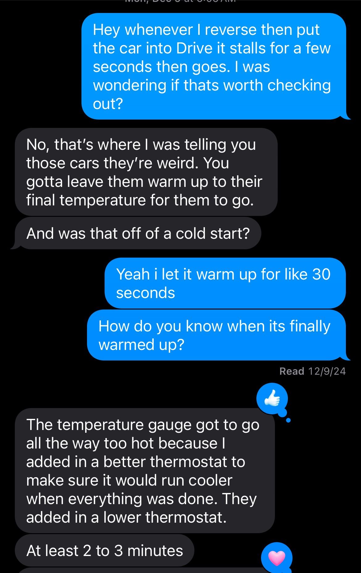

My friend bought a Lexus ls400 with 240k miles and he told me everytime he starts up the car and puts it into drive it delays but it doesn’t on reverse then after 5 minutes it drives normally. The seller told him to let the car warm up 2-3 minutes. Any solutions? No engine light
