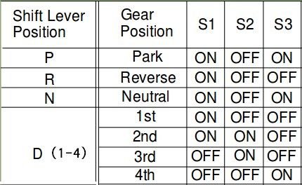

Does the 1st gear do nothing and the 2nd gear works as the 3rd? If so, I worry that the solenoid S1 is not functioning.
When the solenoid S1 is failed to work and is always off, it causes No reverse as well as the Neutral/ Park works as the 4th as well as above problems. See the table below. The 4 speeds Aisin transmission for LS400s and others use solenoids to select gears as follows.
When S1 is always off, the reverse doesn't work and the Neutral forces your car to move forward slowly. In the Park position, the car wants to move forward too but the locking mechanism prevents it. You need to check the function of solenoid S1. First of all, check the resistance. If it's OK, check the actual movement and the clogging of the passage. Sometimes, the transmission speed sensor causes the same problem though.

Quote: Does the 1st gear do nothing and the 2nd gear works as the 3rd? If so, I worry that the solenoid S1 is not functioning.
thanks for the help, this does fit my issues very well as when I have it in neutral or the other gears it feels as if it is in a higher gear than 1st. Should I take the car for a drive to confirm if 1st and 2nd gear aren’t working?

Quote: thanks for the help, this does fit my issues very well as when I have it in neutral or the other gears it feels as if it is in a higher gear than 1st. Should I take the car for a drive to confirm if 1st and 2nd gear aren’t working?
If you confirm that the 1st and 2nd gear behave as I have posted, it will mean that the S1 is not functioning and you will need to check it electrically and mechanically. But as I also have posted, sometimes a failing speed sensor causes the problem No reverse and Neutral drives forward.
