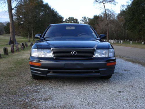

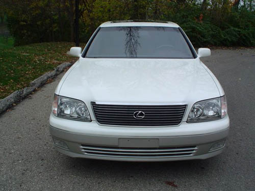

does the front look like this:
or this?
if it's the bottom pic, that uses an entirely different engine/transmission... also technically there is no '3rd gen' LS 400, just 2nd gen (top pic) and 2.5 gen (bottom pic)
your VIN pulls up as a 1997 so it should be the top pic

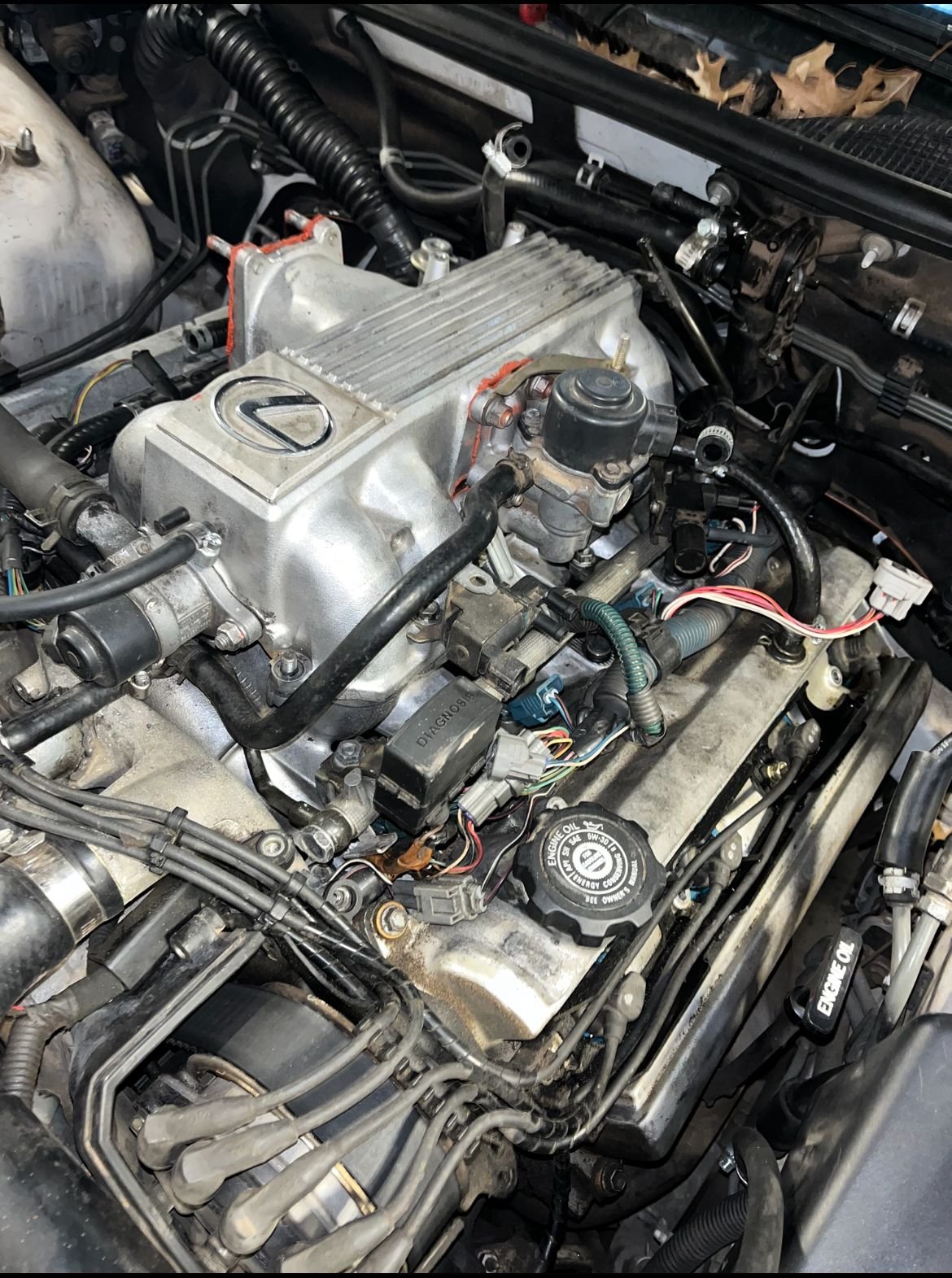

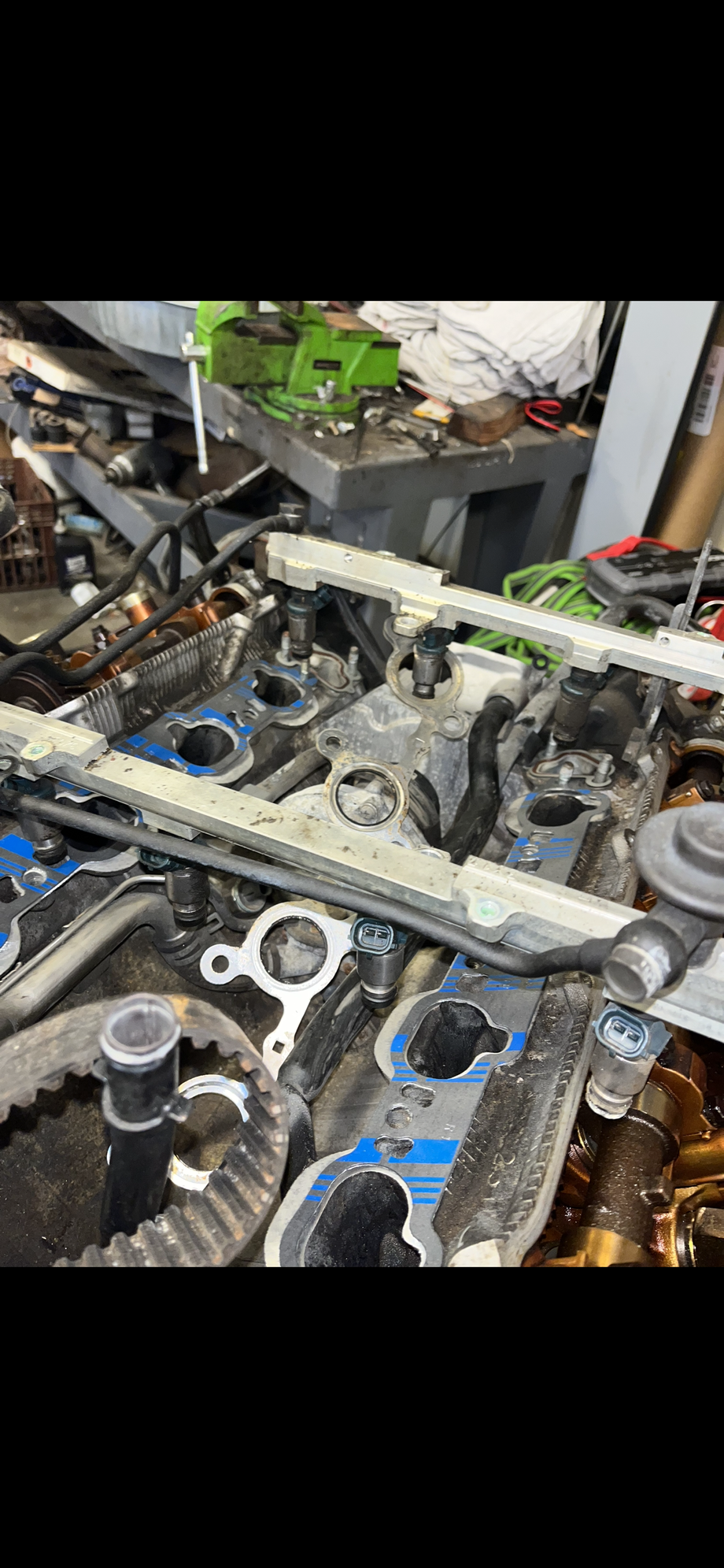

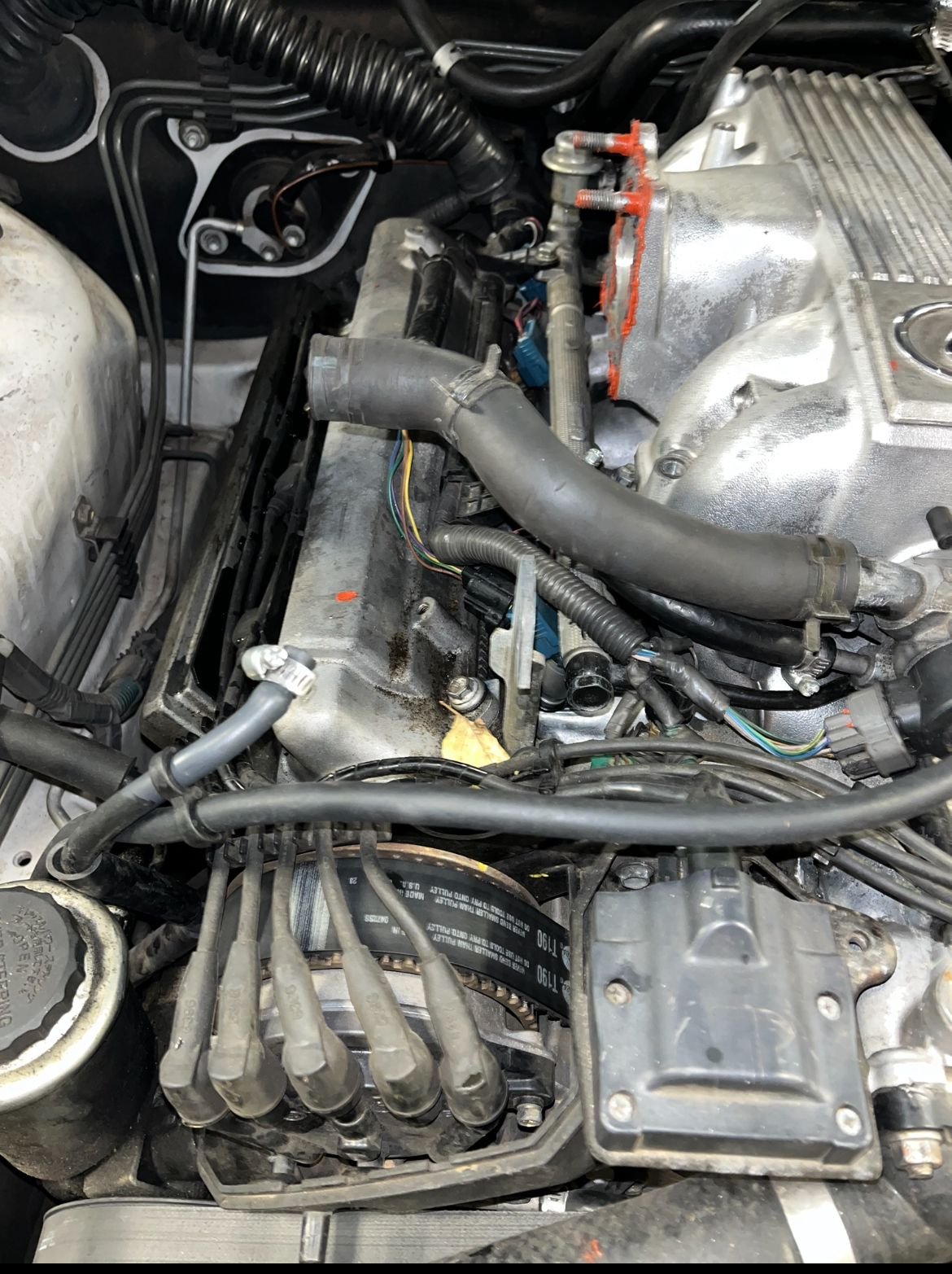

THESE FIRST THREE ARE WHAT WAS SENT TO ME.
THE SECOND SET OF THREE IS MY ENGINE IN THE CAR NOW.

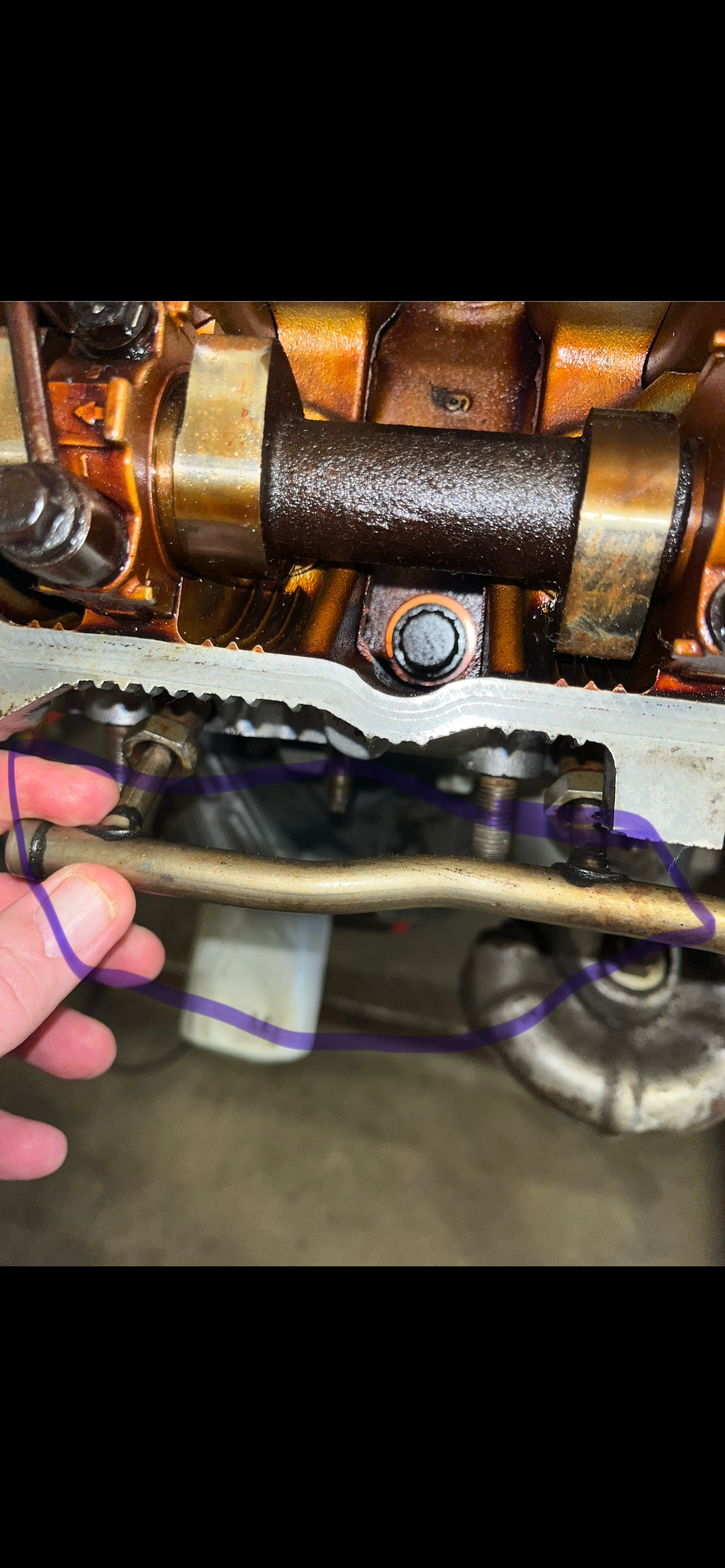

What you are looking at in the valley of your engine bay is the air pump used on 1st gen LS 400 engines from 1990-1994:
https://www.mylparts.com/v-1993-lexu...jection-system
This air injection pump was for California spec cars, and had several additional lines. The CA spec engines also have different fuel rails.
I'm assuming you disassembled these engines partially, which is when you discovered these differences. Is that correct?
To answer your question, no - a JDM engine will not be plug and play, as it does not have the US spec emissions equipment. You will have to swap parts and harnesses onto and off of it with your parts from your current engine.
Both engines you received are no good as they are for first gen cars. They will not work with your car without a lot of modifications since you have a second gen.

Yes! It is the air pump I was told and the rails I circled are connected to that pump and are on both sides of the block. you are also correct about the disassembly of the engines. My mechanic had installed the timing components and then noticed the pump and the lines and called me up there and let me know that it would not work with my car. Also, can I use my existing wiring harness and the ECM or ECU (not sure what it’s actually called)? Is the JDM going to work with mine or do I have to have a JDM harness and comp? I have been talking with an engine comp in California called CAR-PART.com that is telling me that a JDM WILL hook up to my harness and comp with nor problem. Is this correct? Thank you for your assistance

400fanboy mentioned a very big point here - your car is a 97 with an immobilizer. Ideally, you do not want to swap the immobilizer and the ecu modules out. There will be other problems associated with that. You could have the immobilizer circuit bypassed in the ECU, but only those like Kelvin from Cartune NZ know how to do that, and it is not cheap.
Like I mentioned, a JDM 1UZ-FE out of a Celsior could be used if several parts from your engine are swapped over. I don't know all of the exact differences, but I do know the following:
- JDM Celsior 1UZs use a hydraulic fan pump that runs a fan mounted to the radiator versus a hydraulic clutch driven fan run directly from the drive belt
- JDM Celsior 1UZs do not have EGR systems seen on non-JDM engines
The wiring for the EGR is likely not present on the harness on the JDM engine you would order.
If your mechanic is willing to experiment with the JDM engine and figure out the differences in the harnesses, as well as which parts need to be swapped over, then you could give it a try (it could get quite expensive). Otherwise, it would be ideal to locate a 1995-1997 non-CA LS 400 1UZ-FE
In the attached photos, note the absence of the EGR system on the left-side of the engine (bank 1 / driver's side in the US)
The hydraulic pump driven fan can be seen in the Celsior engine bay photo
